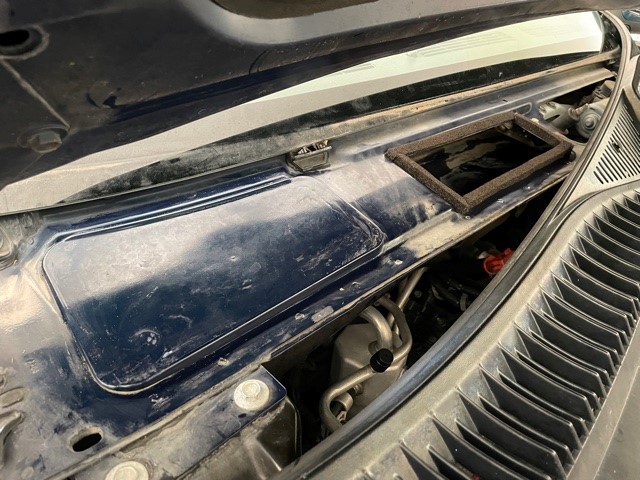

i have 95 tahoe and am getting water drip up where i cant get at it behind heater motor , watched some videos but nothing great..its on pass side..i cleaned up the plastic piece beging collant bottle..cant get into cowl pass side...

Alot of people are having the same issue as you. I had water leaking onto my passenger side floor mat. It was coming down through cracked sealant around a blanking cover, just under the cowl at passenger side wiper. It is the black rectangular piece in the picture. I sealed all around that area with Black RTV sealant. My case was especially bad because water was pooling in my fan blower motor duct, and fried the motor, HVAC controller, and wiring.
