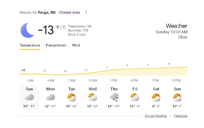

My last job closed the plant here, that was Con-Agra which if you are not familiar is major food/agriculture company.
when I went to the office to see what severance package they were offering I asked about working at a different location, they said North Dakota
f-that! ya'll can keep that cold weather, oddly enough I had already researched because shale oil was gearing up around then but I didn't want to be a human Popsicle
i.e. today's weather in Fargo
