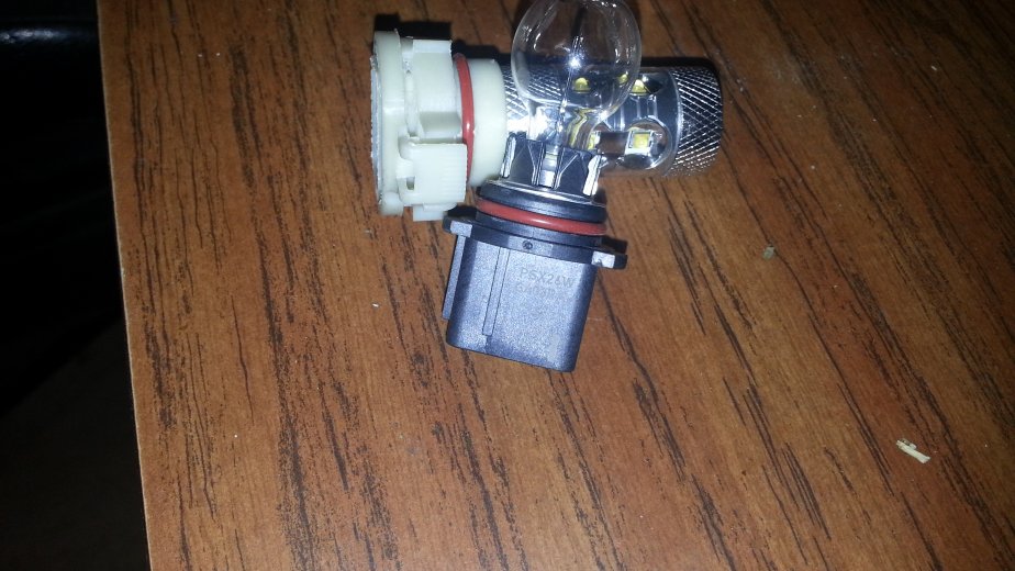

Ordered the 5202_10_XB_W_5K replacement led bulbs from the recommendation of a post on here.
VLEDS webpage list this as a replacement for the PSX26W also.
These DO NOT fit a 2015i version of the Yukon. I'm in the process of returning them and waiting to hear from VLED as to what is going on.
The OEM bulbs have PSX26W and another number G403R printed on the bulbs. These bulbs have 3 tabs that twist lock about 1/4 of a turn into the housing to secure.
The bulbs that were sent have 2 tabs and push straight in to lock.
Buyer beware and check what style you have. If you have to return them, there is a 15% restock fee. So I'm out 9 bucks and return shipping.

Take a look through my thread on this:
http://tahoeyukonforum.com/forum/showthread.php?t=62925
You'll see we ran into the same thing at the end and it also has a link to the correct bulbs.
I would recommend to PM the OP of the post you followed that VLEDS link to and ask them to do the same as I did to my original post (documenting that the 2015i uses a different bulb)

Yes those are the correct ones.
