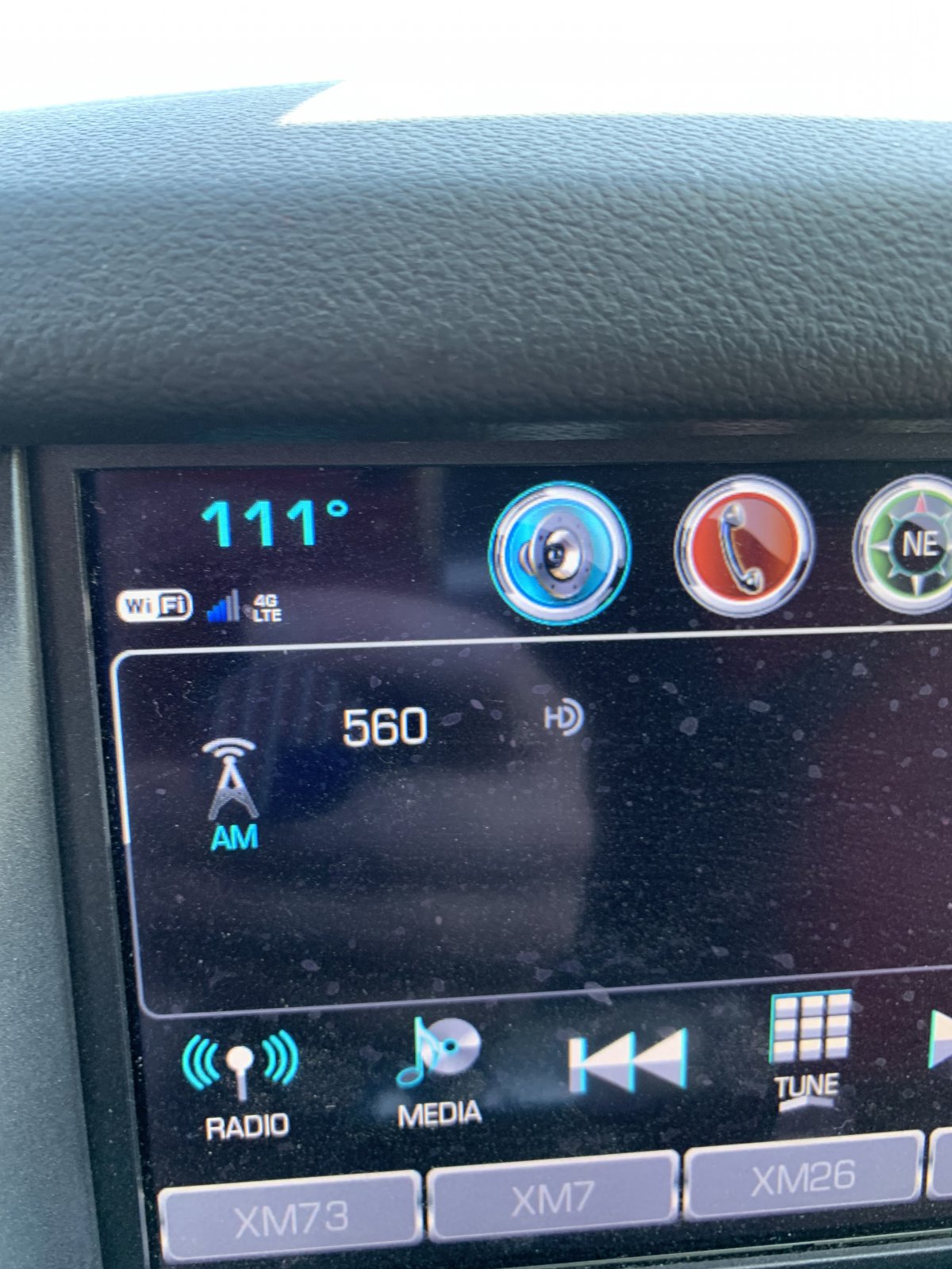

It was very hot this past July.
I usually don't use the AC, preferring to run with the drivers window all the way down and the pass. rr. partially down, using a cool cushion .... truck is glacier white etc yatta. I did this despite the temps hitting 111 degrees. Don't ask, I'm not skinny but it works fine for me. I averaged about 22.5 mpg (25mpg all the way down IL river to Hanibal)
NOTE; this is with the AC OFF and the auto temp control OFF
When I got to Colorado I noticed there was reasonably cold air coming out of a lower duct (I must have had the setting set to exit there). WTH?? The AC is off, the light is off ... When I hit the AC button the car slows down ... when I turn it off the engine says 'thank you', ala any 70's GM. What the hell? why is cold-ish air coming from the dash when the compressor is disengaged? It's impossible, It's over 100 degrees out there.
