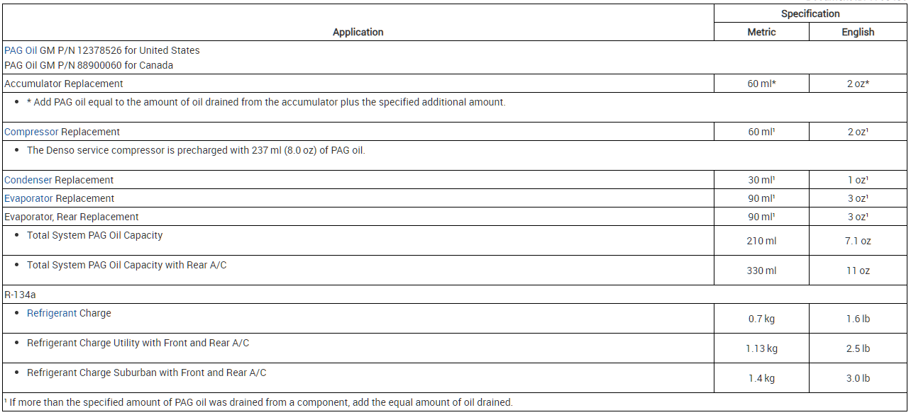

I have the compressor for rear AC. How much oil is required? I changed the compressor back in 2021 but added no oil to the used one. So I'm back here in the same boat trying to make things right after the replacement burned up today

Does this help?

You can definitely put too much PAG oil just as you can too little. I've worked on many disasters over the years from some bad DIY scenarios. Definitely take your time and get this part as close as you can.

If you just changed one part out, drain the oil from the old part for the "balance".
The way it works is to follow the capacity for that part per the chart, but if the oil drained exceeds the amount they recommend that you add that amount back.
Pag 46 if i remember correctly.
I have the ac delco stuff if you need a pn, but it's just pag 46.

Thanks alot guys. Just now getting around to doing this today lol. I will also order the product just fishing has shown me. Didnt know it was possible. Not much oil came from the old compressor. Not sure where it went. I got a used compressor for now. When that came all the oil had wasted out. The plastic plug had come out. So i will add 3 oz for now and add some later if i still here the compressor cycle too much.
