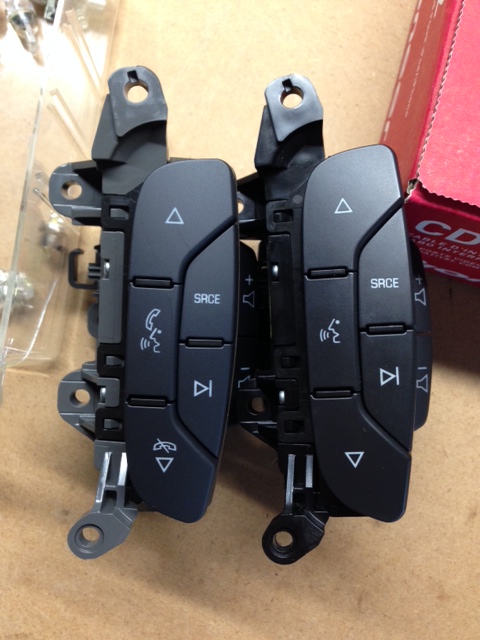

What's the difference in the two? Mines an 08 and looks like the one in your picture I think.
Just got my new buttons. Same plug, same functions. Only difference is the picture of the phone.
Part # without phone 15824119
Part # with phone 2581951

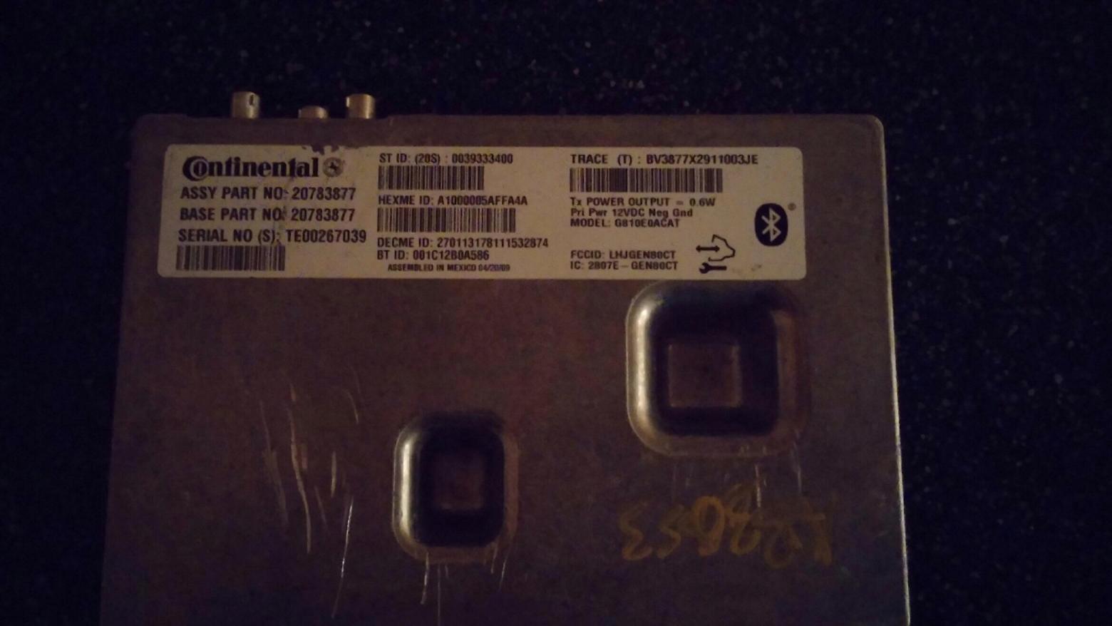

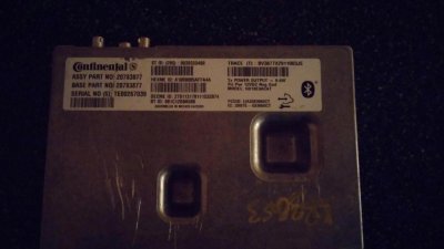

jtjacoby1505
Jan 25, 2013
Found another part number that works. I installed 20783877 that I got from someone on here. Didn't lose onstar functionality either. Hope this helps people in the future. Picture of the unit is below.
What year/make/model do they think you have?
jtjacoby1505
Jan 25, 2013
Haven't got that far yet. I didn't want to say the wrong thing so I told them it was a mistake.
