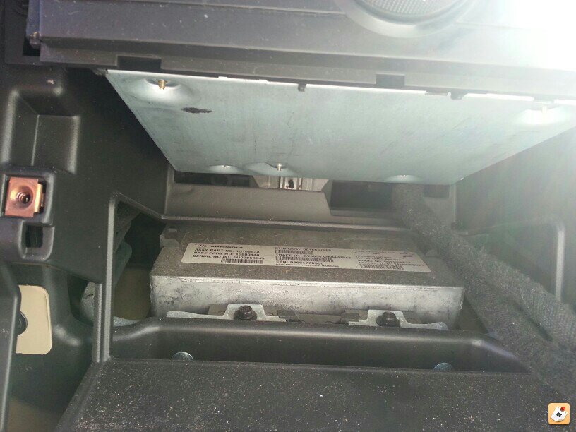

Do any of you have instruction on how to install/remove? My VCIM died on my 2007 Tahoe and I found a used 2010 Silverado VCIM and need to know how to install.
You have to remove the navigation, it's behind there. It takes some time to take the vcim out, has two clips, one on each side. Then direct swap

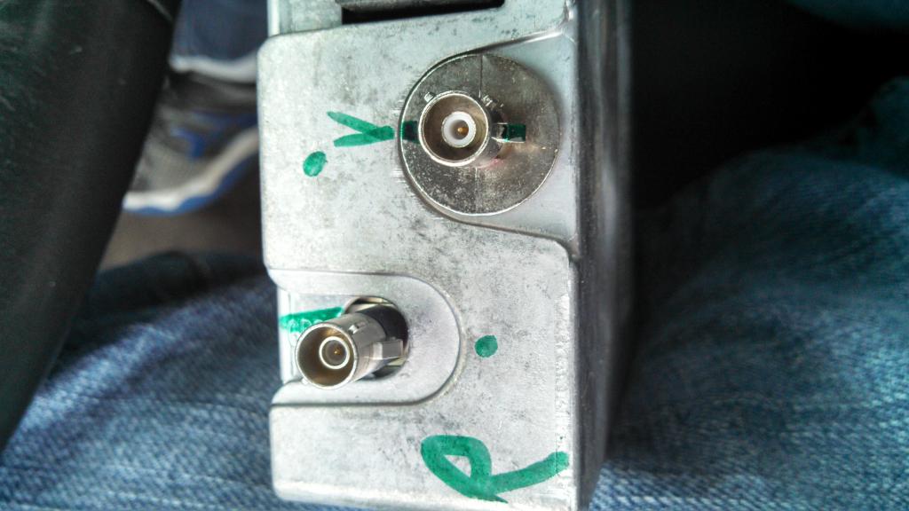

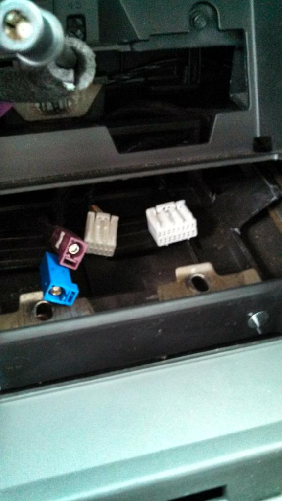

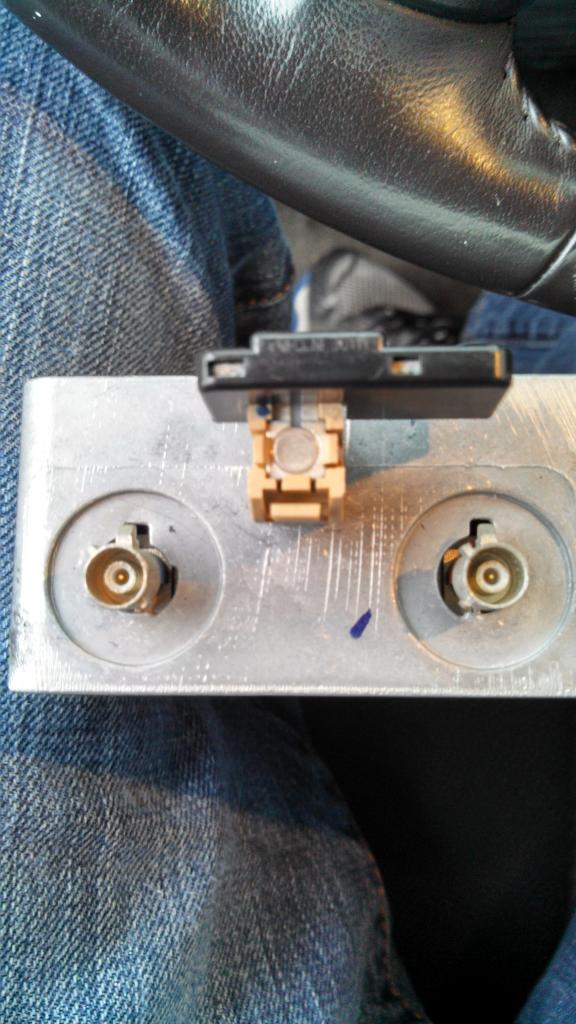

Installed a 2010 Chevy Traverse VCIM in my 2008 Tahoe today. As others have said fairly straight forward install. The two clips on the side do make it a PIA to put back in. I had to over flex them but the did clip back once the unit was installed. Few observations: The coax style (purple and blue) connectors are upside down on the new VCIM, just be cautious when reinstalling. The VCIM is color-coded at the base of those coax style connectors in case you mix something up. I find it helpful to take pictures as you go just incase. That plastic housing has some sharp edges be careful it's a tight space. Below are a few images of the connectors and cables for reference.
