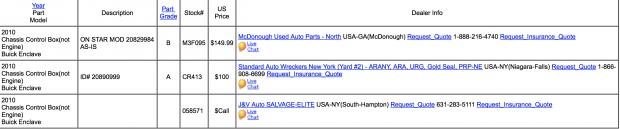

If you find some that work which you don't purchase please forward me where I can get these. I've called a few places and are also waiting to hear back. Mainly looked on car-part.com

The first one on this list from car-part.com should work. The last one might also...but I'd need more information: Screen Shot 2013-11-18 at 8.11.09 PM.jpg
