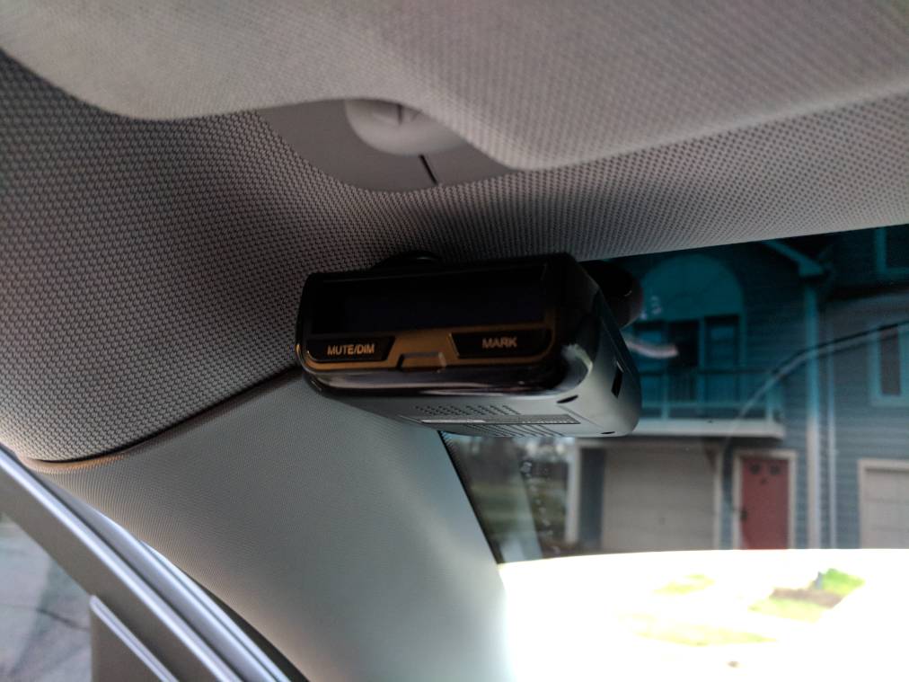

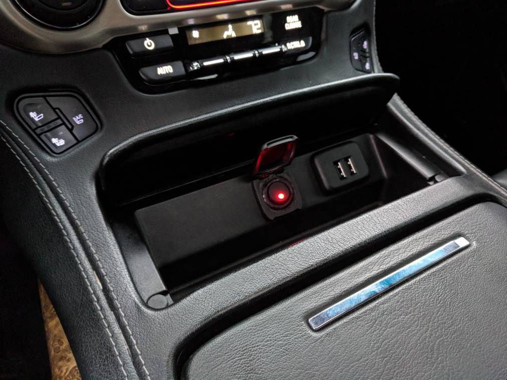

Hi, all. Just figured I'd share. So I was hooking up my Uniden V3 radar detector this weekend, and discovered that those little round all-purpose 12v switches you can buy anywhere fit perfectly in the 12 outlet once you remove the actual recepticle behind it. I usually hide switches in a row someplace super low key, but I couldn't pass this one up. It fits right under the little flap.
I did dremel a couple mm into the top of the surround where the switch sits, just to recess it a bit but you really don't need that. Small bead of super glue around the edge held it in place. I didn't put the bead on the back side because I didn't want to lock up the little tabs that click the housing into place.
Also, stole power from the now-former 12v recepticle wires. Already a switched circuit and right there so it's super clean. Fused appropriately and pow.
Just thought the switch location thing was worth sharing. Cheers.

Not silly at all, dbbd. Good q... It is on ignition power (switched), so it turns on and off with the truck. The manual switch is typically in the 'on' position but is there in case I have to switch it off fast or during a stop while the truck is running. Keeps me from having to reach up (visibly) to the detector to do it.
Normally that wouldn't be an issue, but living in MD, I often drive into DC and VA, the radar detector no-fly-zones. I've run manual kill switches on detectors since 1993. So much habit that I don't even think about wiring it any other way lol
