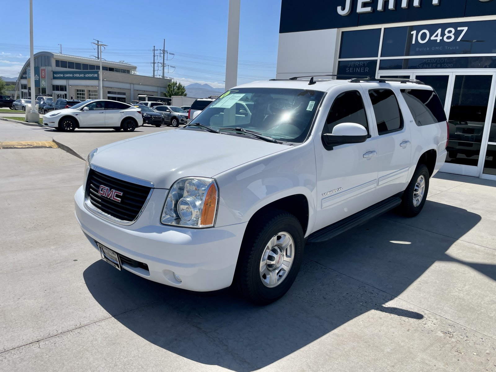

Hey everyone,
I'm at a crossroads and could really use your insights. Currently, I'm driving a 2012 Yukon XL with nearly 200k miles on it. I'm looking to make an upgrade – aiming for a vehicle with fewer miles and a bit more towing power.
In my local market, there are a couple of newer 2019 Yukon XLs equipped with the 6.2 engine that have caught my eye. However, just recently, I stumbled upon a 2013 Yukon XL 2500 with an impressive low mileage of only 115k.
While I absolutely prefer the exterior look of the 4th generation models and all the extra bells and whistles they come with, the 2013 option comes at roughly half the price of the newer models. Moreover, I've been contemplating that the 2013 might have fewer potential issues compared to the 2019.
Does anyone have experience with both of these engines? I'm curious to know how they perform against each other in terms of power and reliability.
21,299
30,254
A 2019 6.2 engine puts out 420 horses and 460 foot pounds of torque. That's enough of a difference that you can feel.
The 6.0 Gen IV L96 puts out 352 horsepower and 382 foot pounds of torque, equivalent to the Gen V 5.3! However, a tune will wake up the 6.0, especially if tuned for 91 octane. Still no Gen V 6.2 though!
My Holiday Inn Express opinion is that the older truck's engine would be more enduring and the heavier chassis of the 2500 would tow better.

@intheburbs thank you very much for the insight! I won’t be towing anything that will challenge either but just would like a bit more than the 5.3 provides.
They’re asking 24k for the 2013 2500 which isn’t cheap but seems cheap compared other options. It’s a SLT with navigation, sunroof, and all the bells and whistles.

Ended up getting the 2013. The newer 6.2 was very nice but also alot more money and we decided against spending that much. Bringing her home today and will try to get some photos! Thank you to everyone that posted and shared all their insight and experiences
