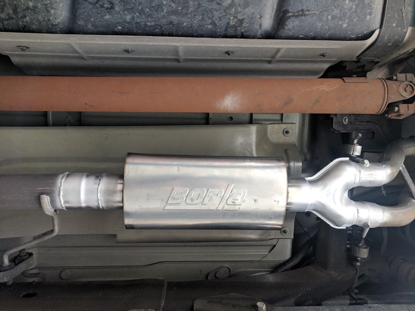

I went with a Borla 40086 in place of the resonator. I’m literally out of room, the Y pipe ends —-> 8” flex connector —-> 3.5” length 3.5” SS pipe —->Bola 40086 —> 4.5” SS 3.5” pipe —-> Borla 40946 —-> SS 3.5” axle back to dual 2.5” to 3.5” quad tip side exits after rear tires. Sound much much better, like you mentioned before that resonator wasn’t doing much of anything at all. I read something about putting a resonator before the muffler to delete tones before being amplified throughout the muffler. As soon as you mention the increase in volume, I had the “hand slapping the forehead duh” moment and it made perfect sense. Thanks a lot for the help I really appreciate it

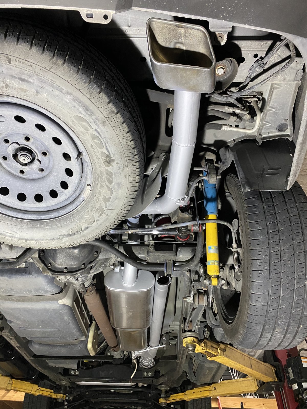

I'm glad you got it handled! I was able to fit my 40" of muffler after getting a short (4"?) flex connector and trimming the end tubes on the mufflers down to butt them together with just enough gap to weld them through. Even then, I had to make a short radius 90° to curve upward to go over the axle, and it was tapered at that. I also fit in a dual valve cutout and a second, unmuffled circuit that runs parallel. It's a mess under there.

this mine lol
little itty bitty thing, actually I had it changed after this to a single out with a dual tip at the end where it comes out at the stock location.
The Carven on the Silverado is even smaller it's about 1/2 the size of the Borla

I'm glad you got it handled! I was able to fit my 40" of muffler after getting a short (4"?) flex connector and trimming the end tubes on the mufflers down to butt them together width just enough gap to weld them through. Even then, I had to make a short radius 90° to curve upward to go over the axle, and it was tapered at that. I also fit in a dual valve cutout and a second, unmuffled circuit that runs parallel. It's a mess under there.
Nice that’s impressive! Really clean! Mines riddled full of Butt / lap joint clamps
45,014
Thank you. Believe me- there's plenty of ZFG welds in it. It was really hot and I kept the fan on and doors open so some welds went to poo cuz the shielding gas was blown away. My response was to block the wind with my hand and burn a giant blob to cover the porous weld underneath.
