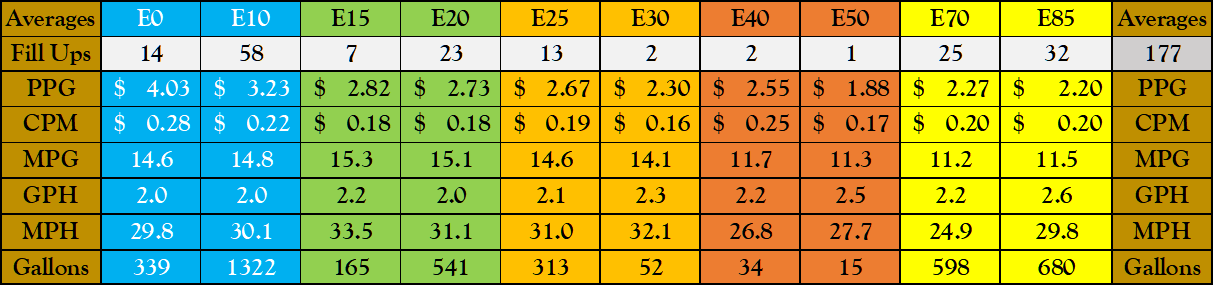

Based on my fuel logs, I would say that an ethanol content of between 15-22% or so makes more horsepower, just enough to decrease the load on the engine and get its best mileage. A higher content makes more power but at this point it burns more, not sure I'm spitting it out right.
According to the chart above, my own experience show that the difference between the two is not as great as suggested.
