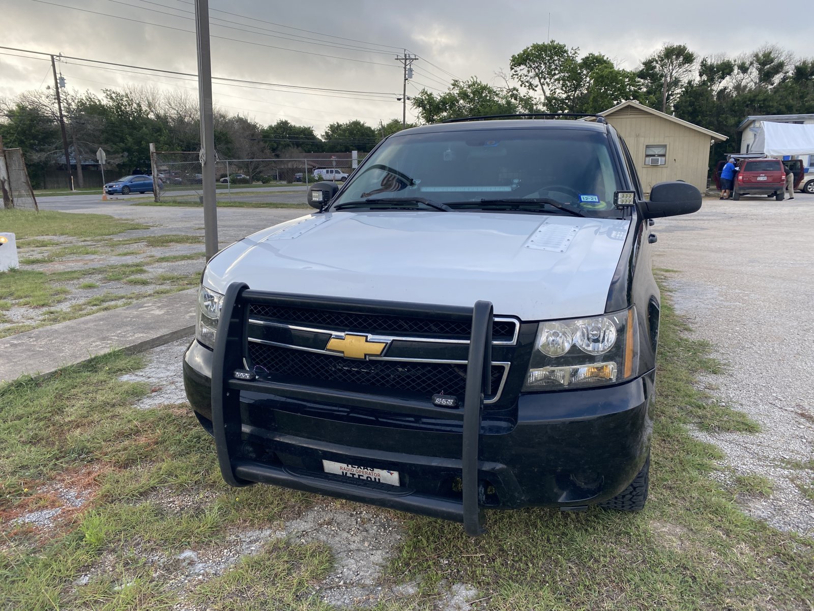

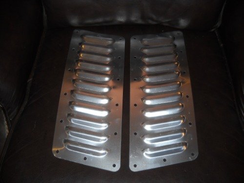

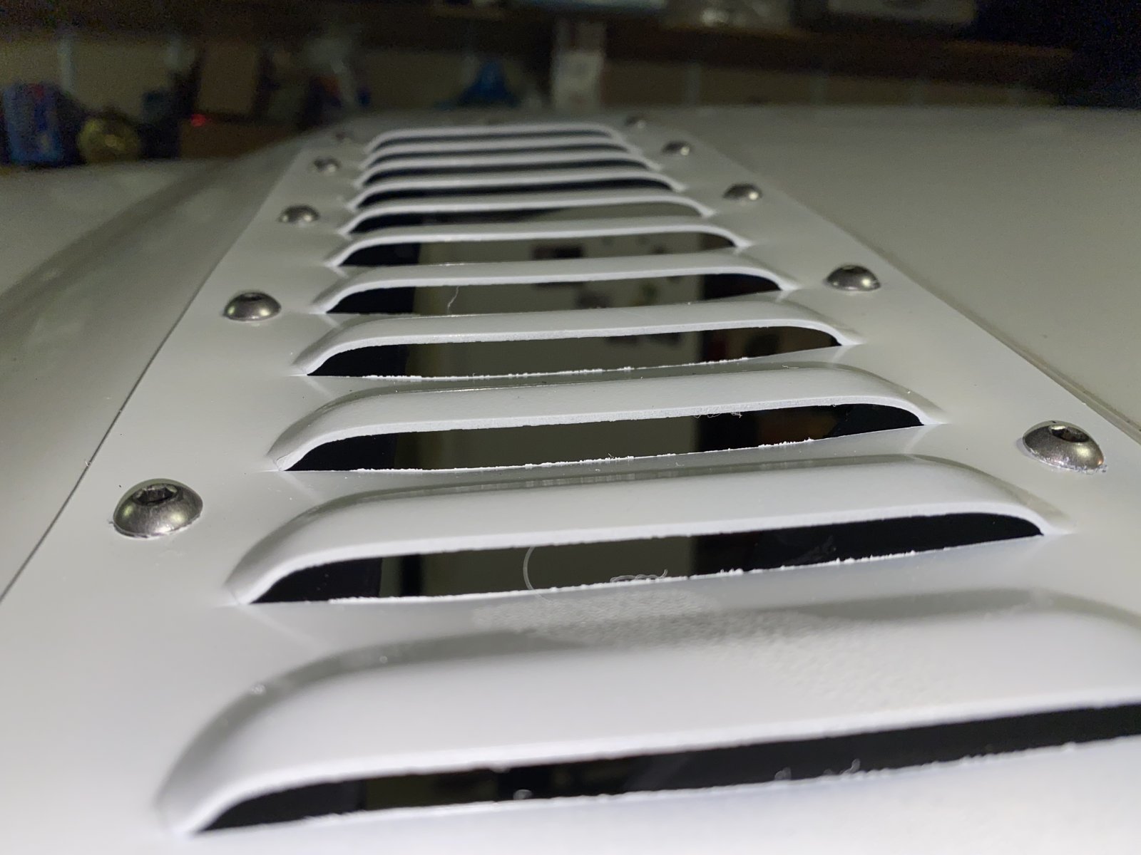

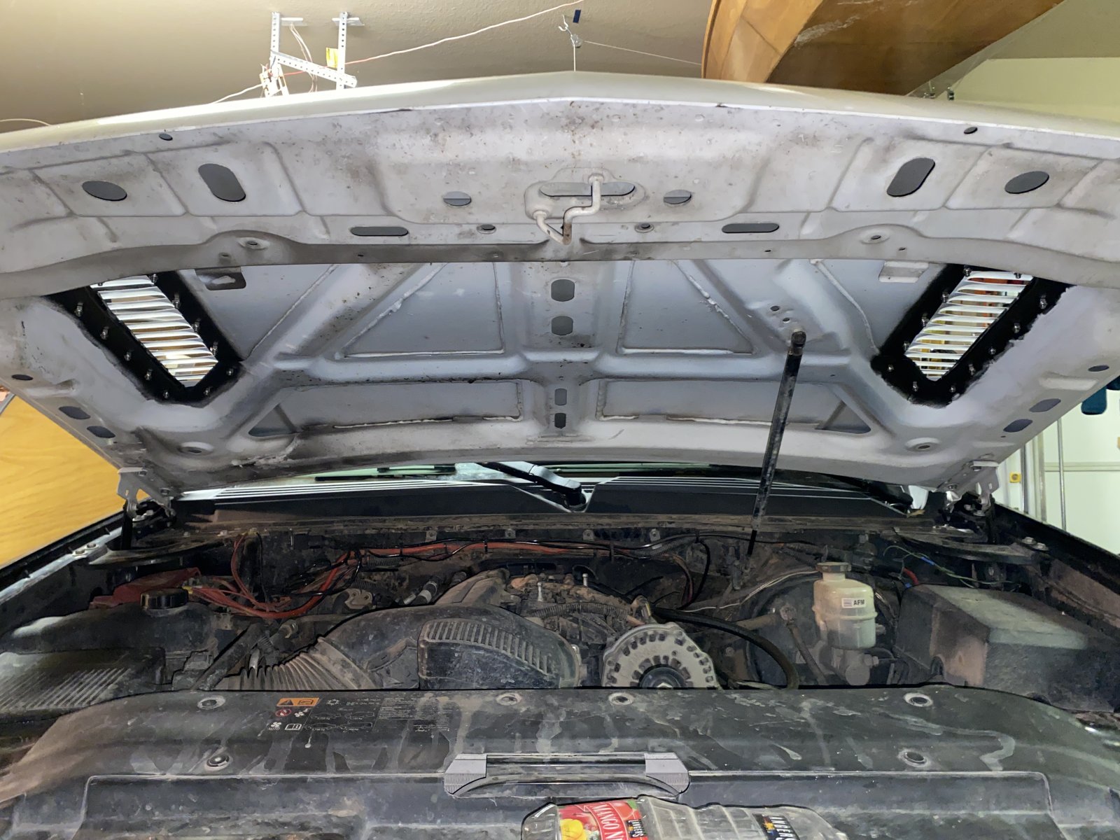

I added louvers to the hood on thecopcar. It was fine in street conditions, but I didn’t like to under hood temps moving slowly on dirt roads.
Holding your hand above one while idling after it’s up to temp, and you can definitely feel the heat rising, even on a hot day.
