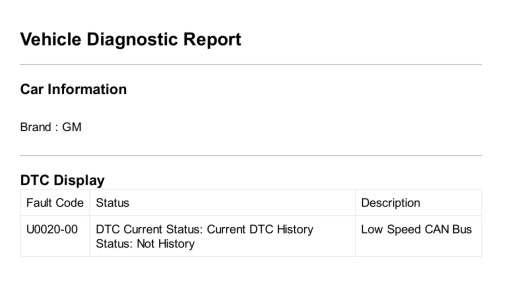

The formatting on mine is terrible but notice mine says "DTC Current Status: Current". I did a full scan once before and didn't get this but it did have some problems reading all the modules last time I did it and this time it went through them all.
Mine is a 2015 GMC Yukon so I imagine this is likely not uncommon of a code and likely doesn't throw a dash light. Interestingly this module uses the low speed CAN.
In my case I cleared it and it was the only module alerting at the time. We'll see if it comes back.
