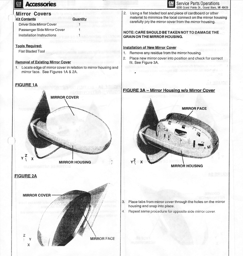

These are for the NNBS mirrors, but the process was basically the same:

Yeah, use a thin prying tool to slowly work the caps loose if you are swapping them. I used a butter knife the first time I did it. But a plastic trim removal tool will work better, Les risk of scratching it. You can get those plastic trim tools from Harbor Freight or most auto parts stores have them now too. It's basically a small plastic pry bar.
I have an assortment of them since I used to install car stereos and alarm systems. I needed them to take dash panels and interior trim panels off without damaging them. I used to just use a flat head screwdriver back in the day, but I quickly realized that was NOT the way to do it.

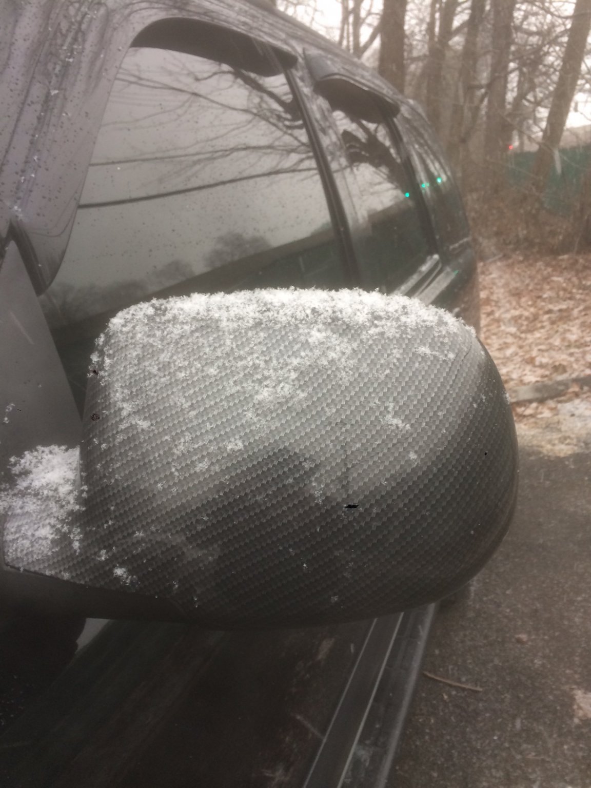

here is a pic of my drivers side mirror (there are no black marks on it, my I-phone just sucks lol)
