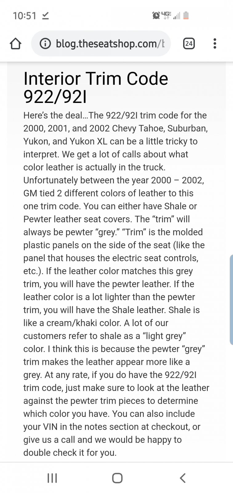

Mine is 06 with 921/922 which is med drk pewter, blah blah. Not sure about the whole sheen thing on the plastics. I was thinking of how the 921/922 codes were used for a completely different color set for the leather (which I realize is not what this thread is about).
