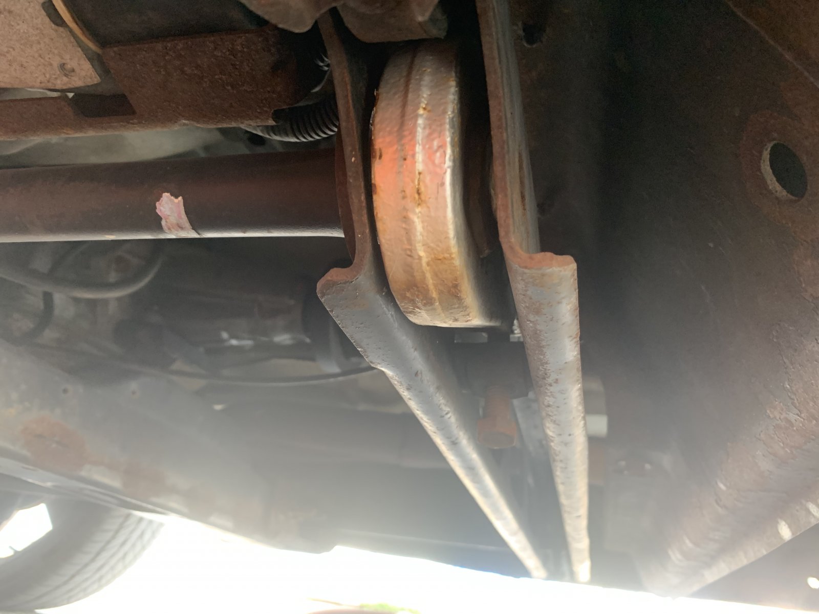

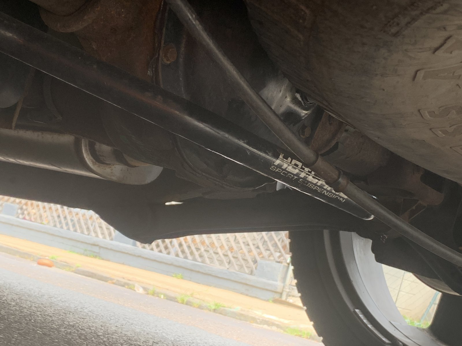

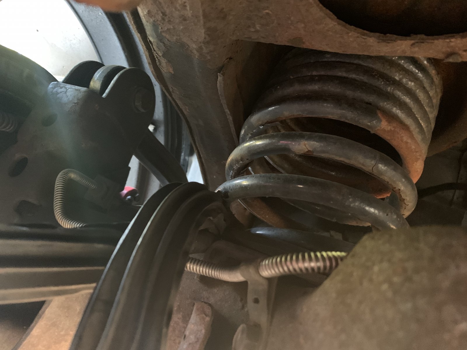

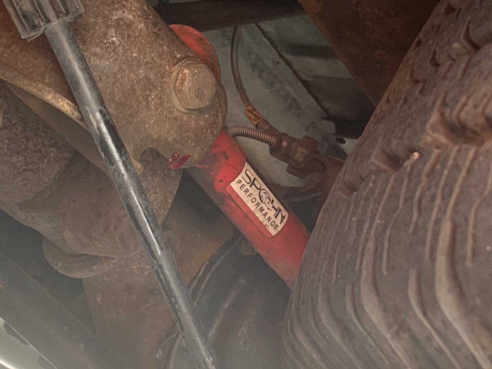

02escalade
02escalade
Jun 16, 2021
33
14
New jersey
02escalade
02escalade
Jun 16, 2021
33
14
New jersey
Do those springs look normal ?? Look really compressed but they are eibach lowering springs I’ve been working crazy hours so I haven’t really been able to look but my buddy asked me to take a few pictures for him
