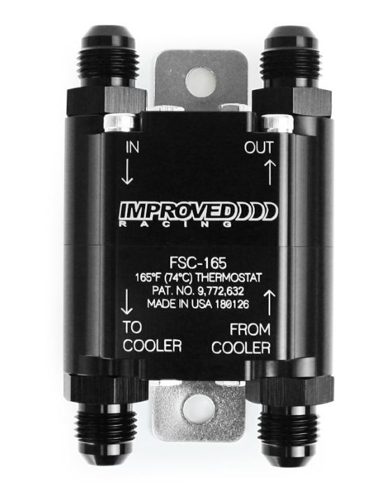

A thermostat I like is this one that comes with 6AN fittings and can be ordered with different thermostat settings. A bit pricey ($159) but in the grand scheme of things not so much.
Cut into the side coming out of the radiator (liquid to liquid cooler) to the liquid to air cooler. You want to have the liquid to liquid cooler help heat up the trans to operating temperature.
It's pretty simple... splice the thermostat into the lines going to the front, liquid to air cooler. Return to transmission is the driver side hose on the cooler... the input (hot line from liquid to liquid cooler) is the passenger side into the liquid to air cooler.

That bypass in your picture was too spendy for me to warrant buying. Derale makes one, I just bought it. Seems to work, at least for first mile of driving haha... I finished installing it minutes ago.
Only big difference is it doesn't come with the fittings like that you have to buy them / adapt it to what you want to hook it to. It also appears to be a cast part body that one is machined from billet, would be super expensive to make, probably why it cost so much.
Derale has a always flow / cannot plug design feature that makes it a bit more attractive too. Not sure if that one is that way or not...
