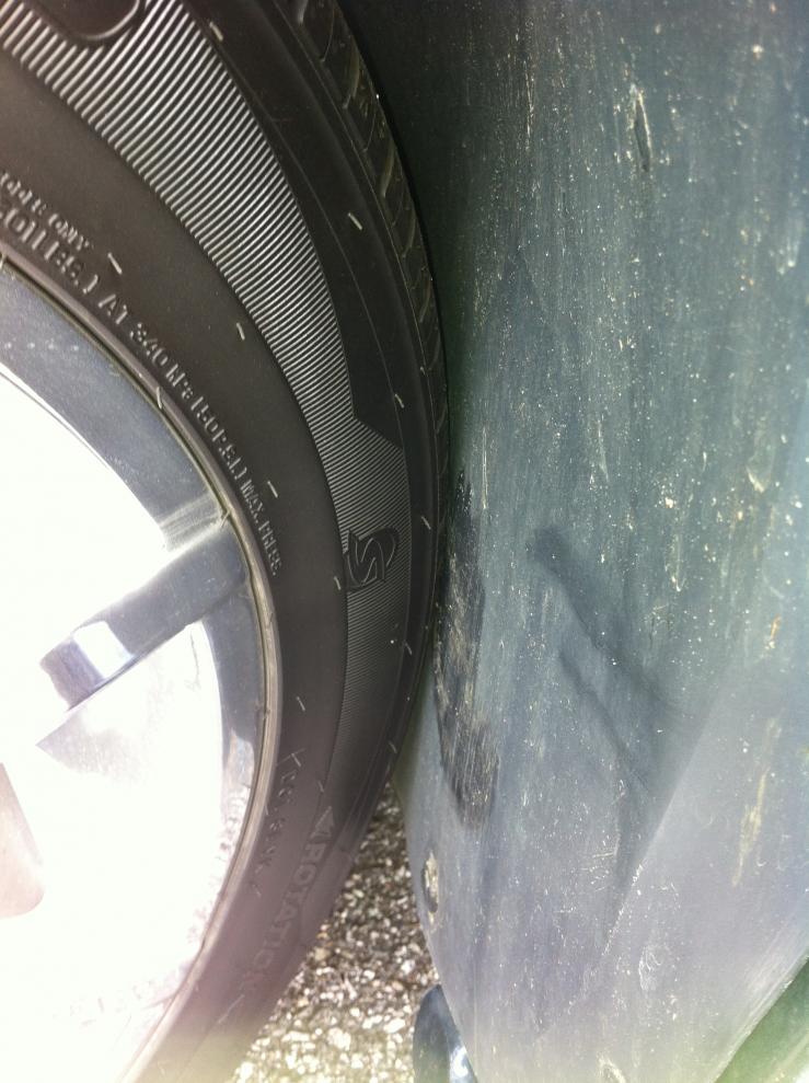

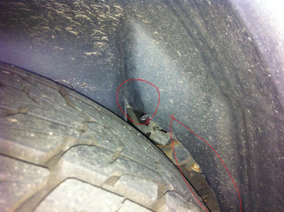

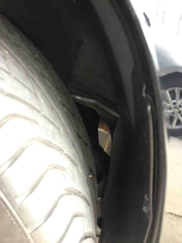

I've got Tony's 2/3 belltech kit with 305/40r 22's on kmc slides.
I've got 2 problems.
1. both front fender wells are rubbing when turning. Is the fix to heat them up and bend them in somehow?
2. both rear fender wells are rubbing when the Tahoe enters an uphills slope when all the weight it shifted to the rear. I've had the fender wells trimmed, but I think I need them trimmed more. How much have you guys trimmed off? And note I first didn't have the rear spacers in and it was really rubbing. After I put the rear spacers in, its not as bad, but still rubbing.
Attached are some photos
thanks.

I actually I just pulled the liner in the rear with zip ties and it has helped the rubbing and i am running 305 35 24s.

For your rears I think you trimmed off enough those bumped out sections that are catching are common and are an easy fix. I have a monokote heat gun that I use to get em nice and soft and I press the bump out until it's basically inverted. I use the handle end of a rubber mallet to push them.
While still warm the plastic will try to revert back to it's original home, but if you keep them pressed for a minute or two of cooling they will stay without issue.
I have minor rub up front with the esky reps only at full lock so I haven't done anything with those.

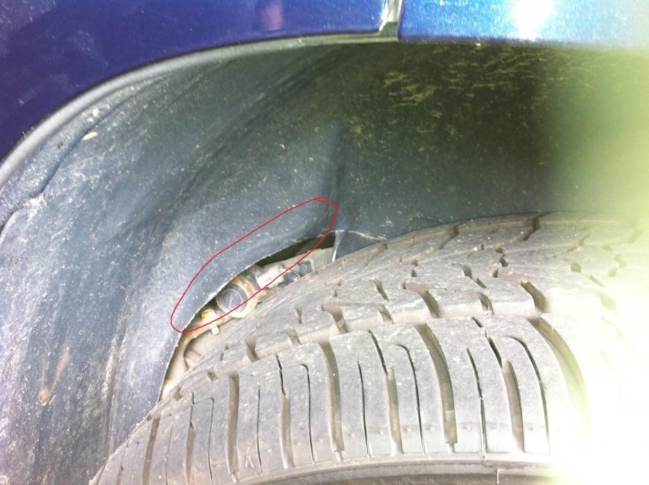

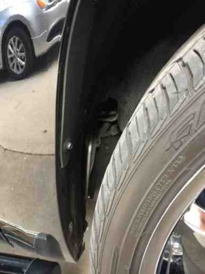

FrontLeft ( rear of wheel)
26" with a 2/3

anyone's pics :) just to compare so I know how much more I need to trim off.
