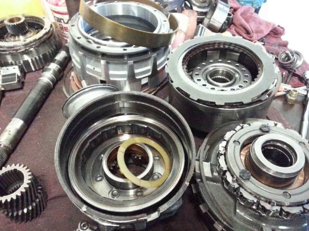

Pics of the Fully built 4L80

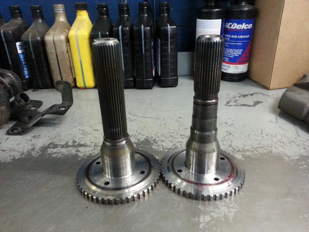

Outputshaft

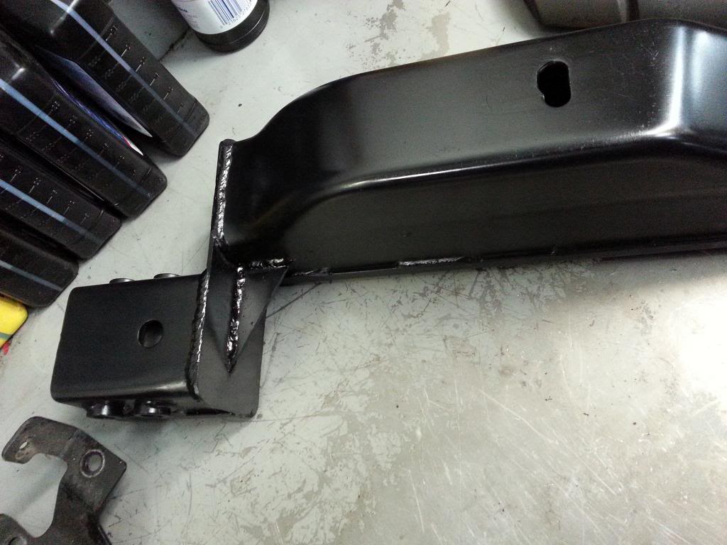

Custom 4L80 transmission cross-member

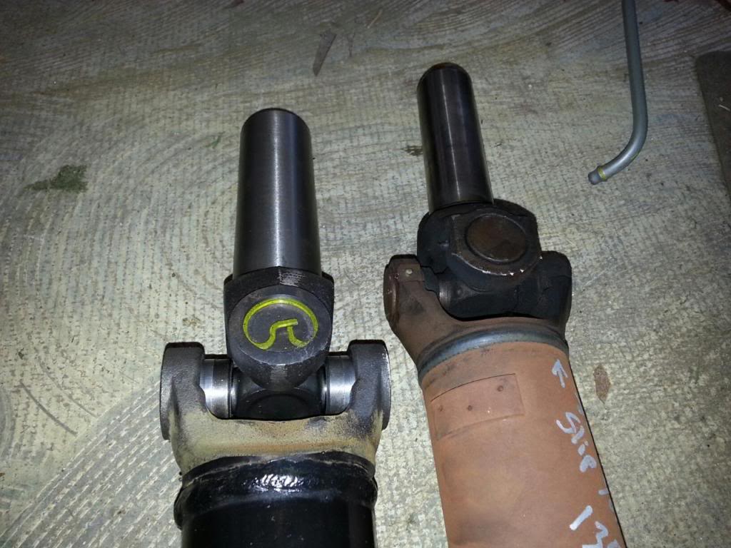

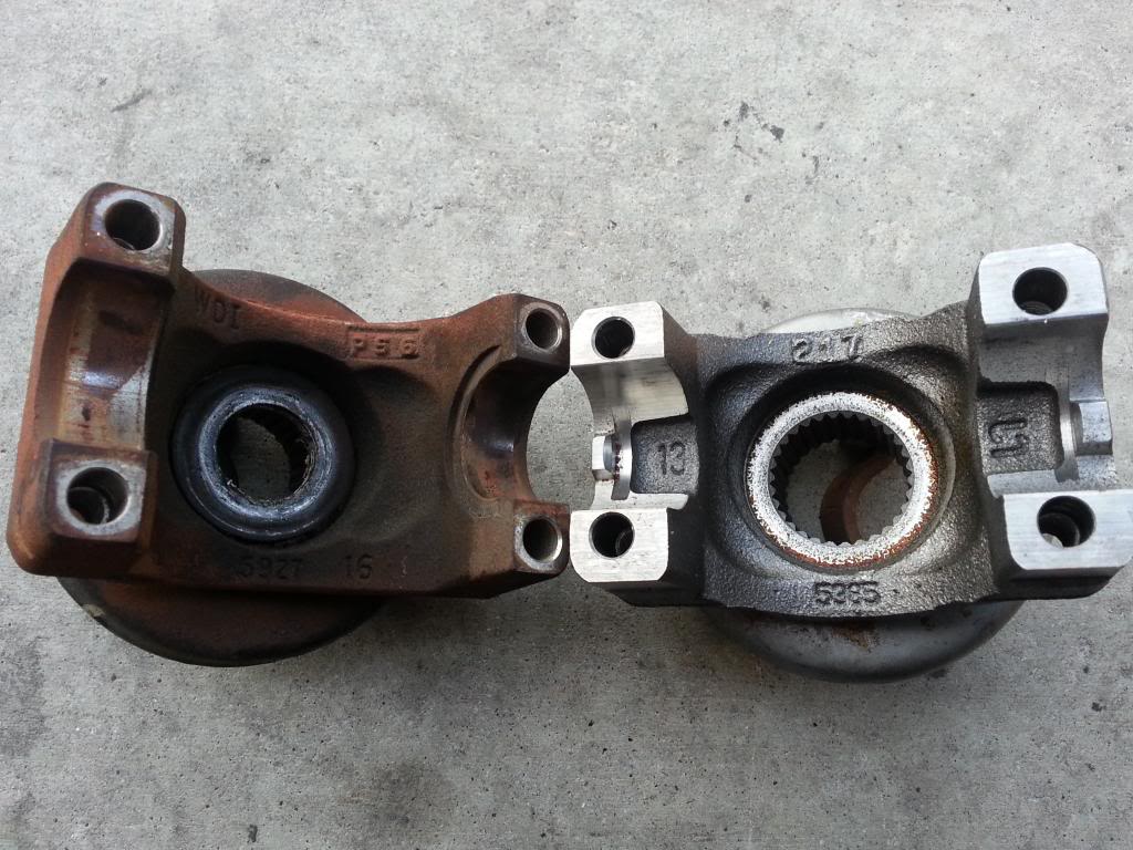

Custom Built Drive shaft with full 1350 u joints, not hybrids both front and back.
1350 Vs 1310
1350 vs 1310 Yokes

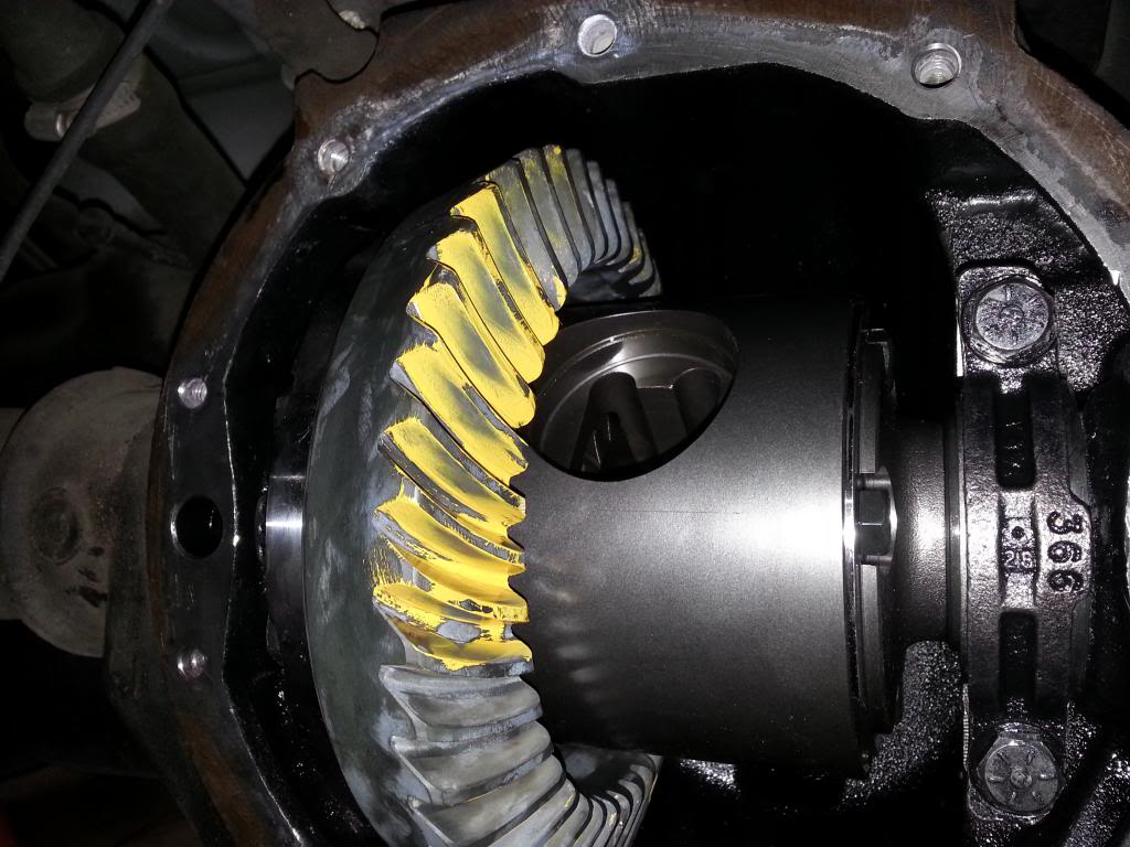

Tru-Trac and Gears installed
Backslash was set at .0075 and the contact pattern was perfect

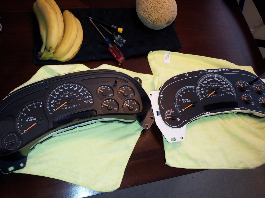

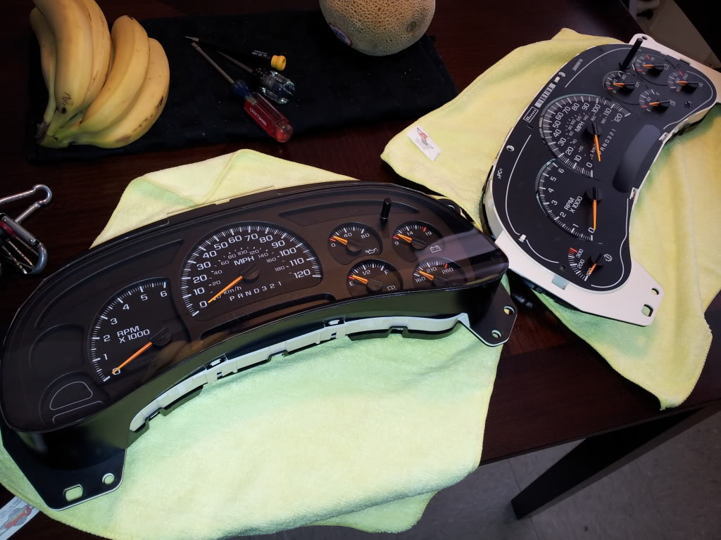

Well i finally got my Cluster, i bought the cluster on ebay and it came with a messed up Lenses so i replaced it with my original one,
here are pics of it
Trans doesn't even over heat running at 125 constant

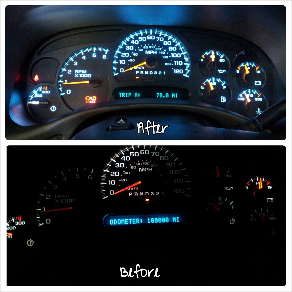

here is a little update, finally got my Cluster fixed had a bunch of bad bulbs, i think the out come came out very good
