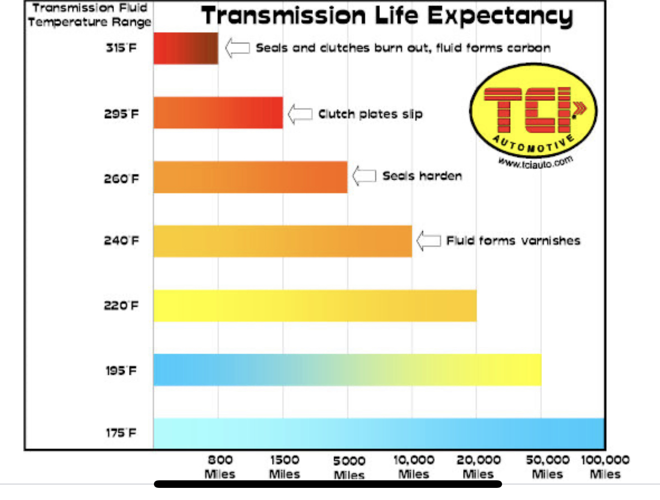

It was hot yesterday and I was towing my horse trailer for about 3 hours, up and down some pretty significant hills. I noticed my transmission temp got up to 238 at a couple of points. The trailer is fairly high profile and, with the horse and tack, likely weighed about 4500#.
Tahoe is a 2013 SSV with the normal SSV options, 170k miles. As I am reading it, 238 is too hot. Any suggestions?

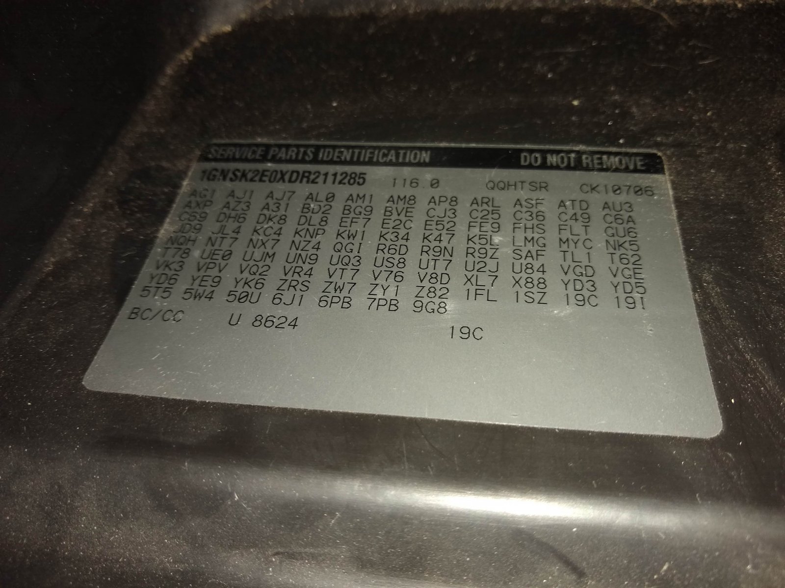

Did your SSV come with the HD cooling options?
M
Mikana31
Mar 27, 2020
18
19
If that's indicated by the K5L on the service parts identifier sticker, then yes.

It does, and Tow/Haul was on the entire trip.
Make sure your tires are at max inflation so they roll easy - and when it gets hot try locking out 5th gear, run in 4th - Curious , what size tires do you have?

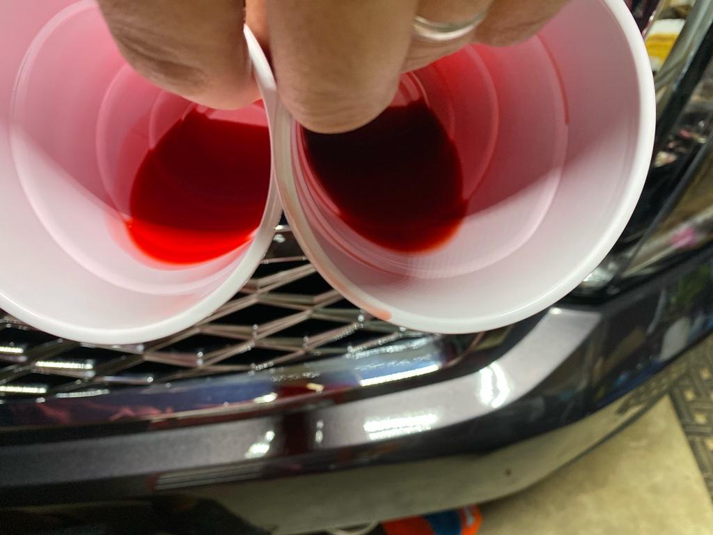

Decided to exchange some fluid only after towing. AMSOIL signature has about 4K miles on it and prior I did the full exchange (10 of 12qts) and filter. Didn’t know I was going to towing. This time I exchanged a little under 5.5 qts.

I have a 2013 Suburban 5.3 w/ 6 speed also. Just towed to Virginia 800 miles. It was hot out. In the moring I didnt touch 200 degrees. Afternoon 200-215 all day. 1600 miles of towing and my trans fluid is still cherry red as it was changed out 5k before I left for trip. Very important to check coolant condition. The other things guys forget it to blow out radiator and cooler fins with compressed air from behind. I had my bumper off to put in an LED light bar and you would not believe the crap that hit that floor from the fins. Make sure you have protective glasses on when doing it. Good luck
21,274
30,204
Don't let it get past about 36K-45K or sooner if you tow the same again. I did a week of local towing on mine and the BlackStone Labs report said it had about 10K miles of life left in it at 36K. The hot warnings don't come on until the 260s.
