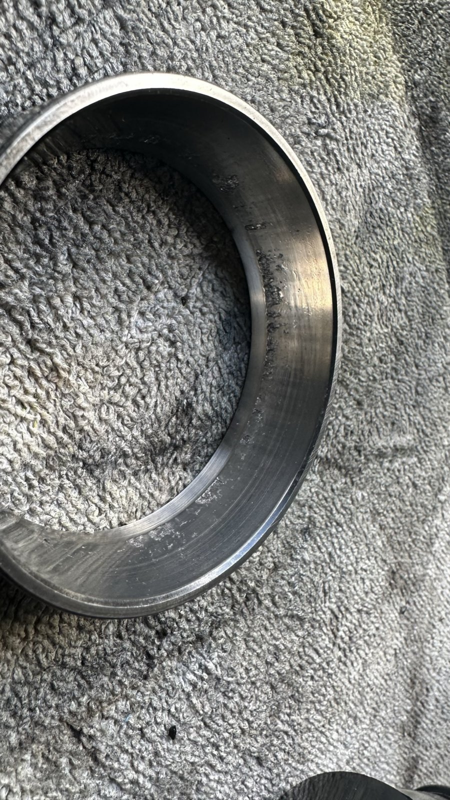

One the the races in the dif looked like that.
Could this be the source of the problem?!

Actually the bearing didn't even look that bad.
The bad race is from the carrier bearing. The two on the pinion look like they are alright.
Yet I will still replace all of them, of course.
I couldn't see the surface of the races before disassembly, so there was no way to tell just by visual inspection.

I had the same symptoms on my 99 Sierra Z71. It was the rear axle bearings. Pitted just like yours. Had the noise for close to 2yrs before I fixed it. Im lazy like that.

With Glitter in the Rear end oil consider changing Wheel Bearings also while it's easy.

That race looked bad. Did you replace the pinion bearings? How did you set the preload and crush the collar?
Yeah, I replaced all bearings and races in the axle. I reused the old pinion shim. Since I didn't have the chance to buy a cheap torque wrench with a scale in the range needed here, I used a rod, measured the length of it and used the yoke bolt holes to attach it. Then I calculated the force needed to rotate it with the given length and used a spring scale to measure it.
Probably the pinion depth is not 100% right which causes the soft noise on coast. The gear pattern looks like the pinion is just a very small bit too deep. But not too much to worry about an extreme amount of wear in my opinion.
