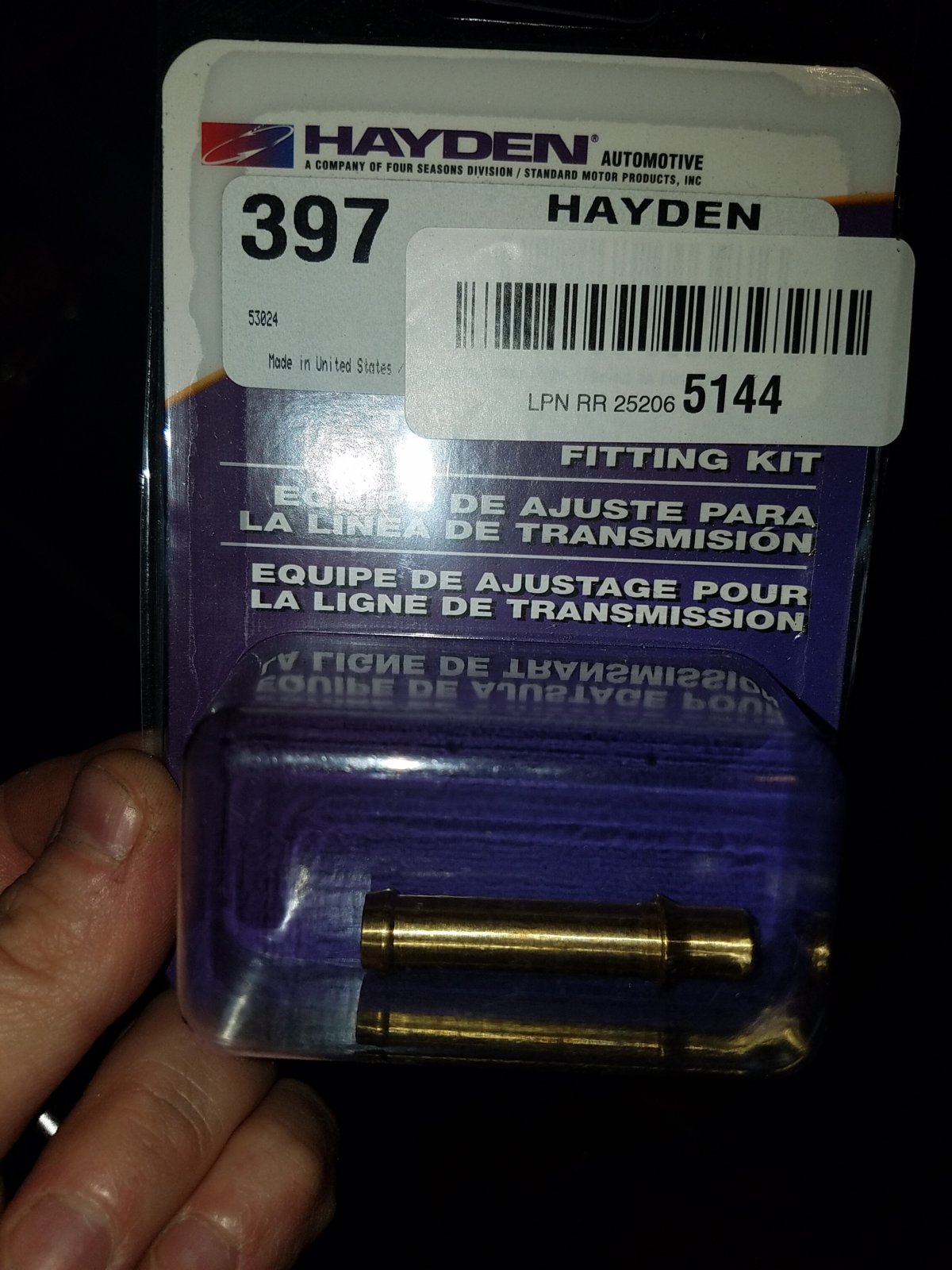

Whats the part number for the fitting everyone is using to do the flush?
