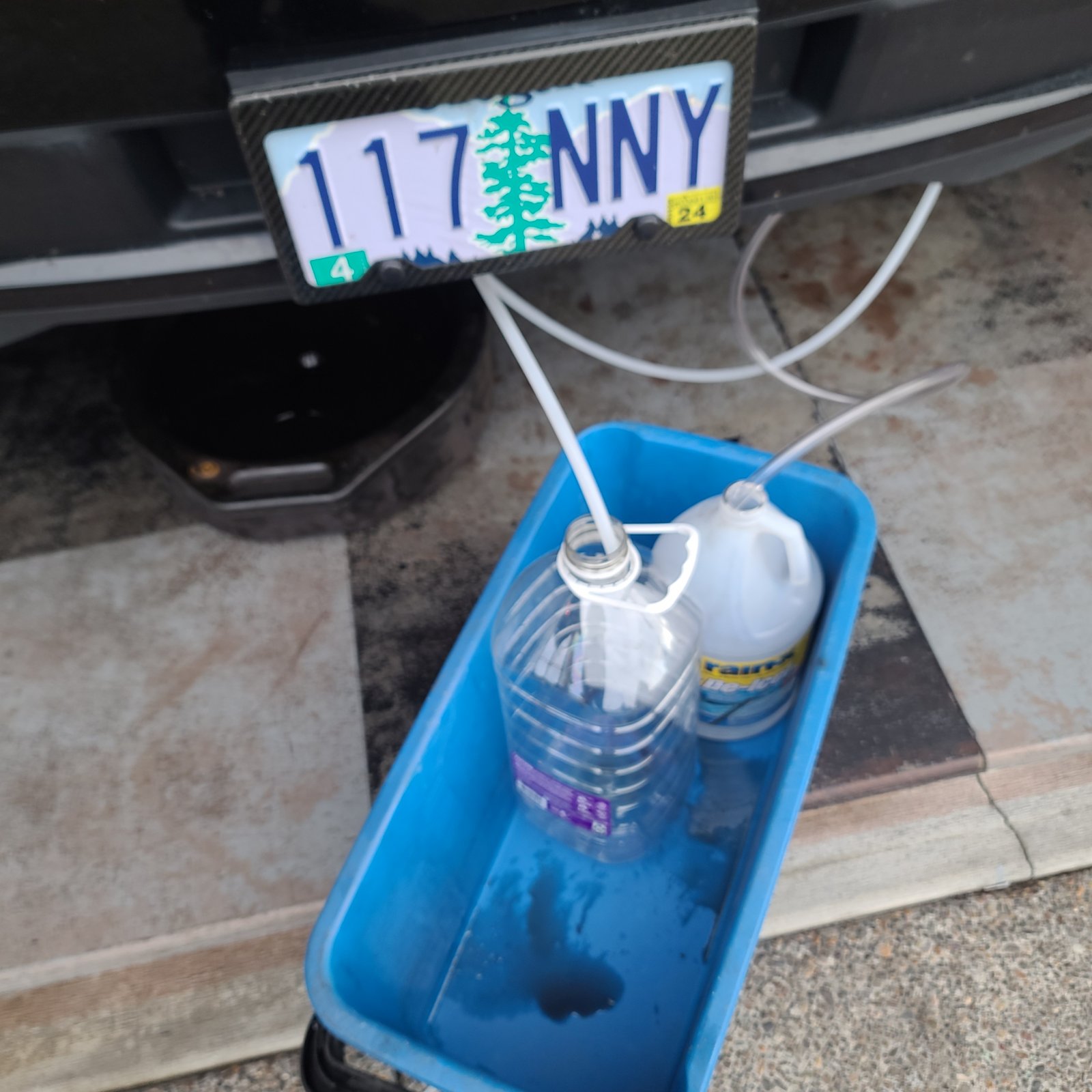

My 2018 Yukon Denali was due for a trans fluid & filter. It's insane what they charge to do the 10 speed fluid & filter change. I watched a few videos, bought 12qt of AC Delco ULV transmission fluid & filter for $125 and I used 2 8ft pieces of tubing.
Need 3/8" OD tubing to plug into the radiator trans return line. The other tube connects to the trans cooling line you disconnected from the radiator because it will spit some out when the engine starts.
1 - Once tubing is setup I started the engine & let 3qts drain then shut off engine. Trans was already at temp before starting.
2 - Removed oil pan & replaced filter. Cooling lines at trans had to be disconnected for pan to drop.
3 - Installed pan & cooling lines to trans then added 4qts to transmission.
4 - Started engine & let fluid drain as I added more to the transmission until all the old fluid has been removed.
Total time including putting the Yukon on/off 4 jack stands and a tire rotation took 90 minutes.

When you added the fluid as you drained, was it directly into the tranny fill port, or to the cooling line return?
I filled directly into the fill port while the engine was running and the trans return line disconnected. Once 10qts were added I turned off the engine, reconnected the trans return line, started up the engine then added the remaining trans fluid.

Yeah she probably quoted a 6 speed. Also said I needed to drop it off at 7am and it would be there all day, so that's a hell no from me. 12 qts and a filter is about a hundy from RA, so Ill give it a shot. Its used, so I need to check the magnet and fluid anyway, but Im not excited about dropping that big ass sloppy pan around the exhaust all over me...
If you have a 10 speed it has 2 magnets in there. Before dropping the 10 speed pan I started the engine & let 3 qts drain, turned off engine then dropped the pan. The pan drops easily once you disconnect (1 bolt) the trans cooling lines from the side of the transmission.

Oof, way too high. I got the juice and filter, just waiting on a fluid pump. You took 90min and I saw another on here take 12 hours; hopefully I can get it done closer to your time...
The only sketchy part is disconnecting then reconnecting the transmission return line. I use a small pick with a curved end to partial remove the "don't lose me" clip then grab it with a needle nose. There may be a tool that slips over the return line that slides in to release the clip. None of mine fit.
I used 2 8ft of clear hoses to capture the fluid. 1 3/8" OD & 1 3/8" ID.
You should install the "don't lose me" clip before installing the transmission return line. When installing the return line it should just click in place. If correct the black collar will slide on & be 100% flush. If not 100% flush that line or clip is not right & the line may pop off later..
I'm sure my next time will get done is less than 1hr. Not doing it before I took my time. I use a cheap Harbor Freight manual pump that transfers a qt in ~ 6 pumps and the supplied hoses fit in the transmission & bottle.
