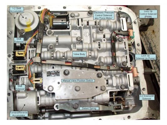

Bad pressure control solenoid or sticking associated valve which is usually caused by bore wear or dirty fluid.

I have it scheduled to be rebuilt the week after Christmas. The truck has 160K on the original fluid. I spoke to my mechanic when I first got it and he said that if I changed transmission fluid that old, I would be rebuilding it sooner than later. He said just ride it out until it wouldn't go anymore so thats what I did. I don't really want to keep messing around with it since its my daily driver so a rebuild is what is going to happen. That way I can just move on. Thanks for helping make that decision.
