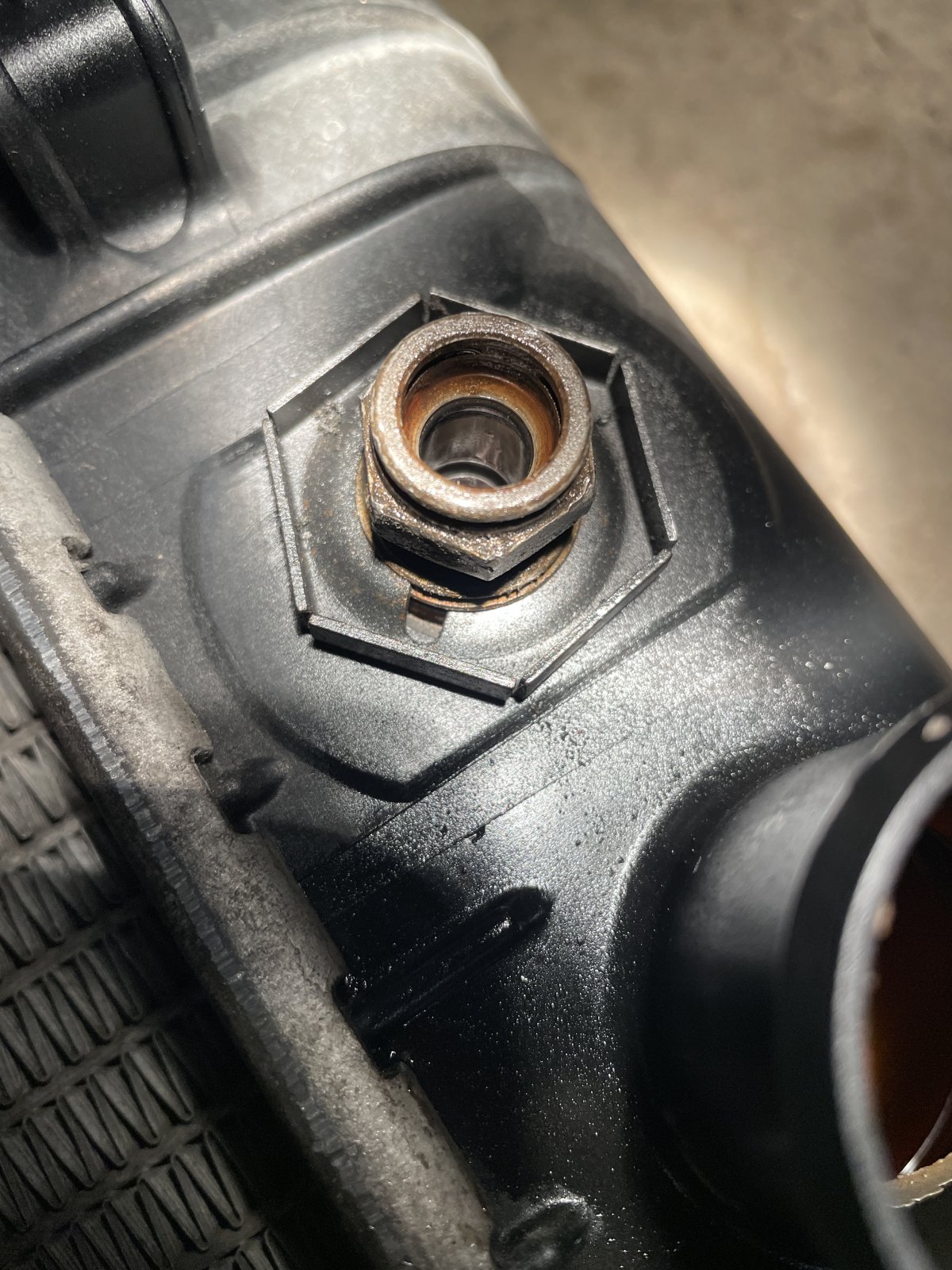

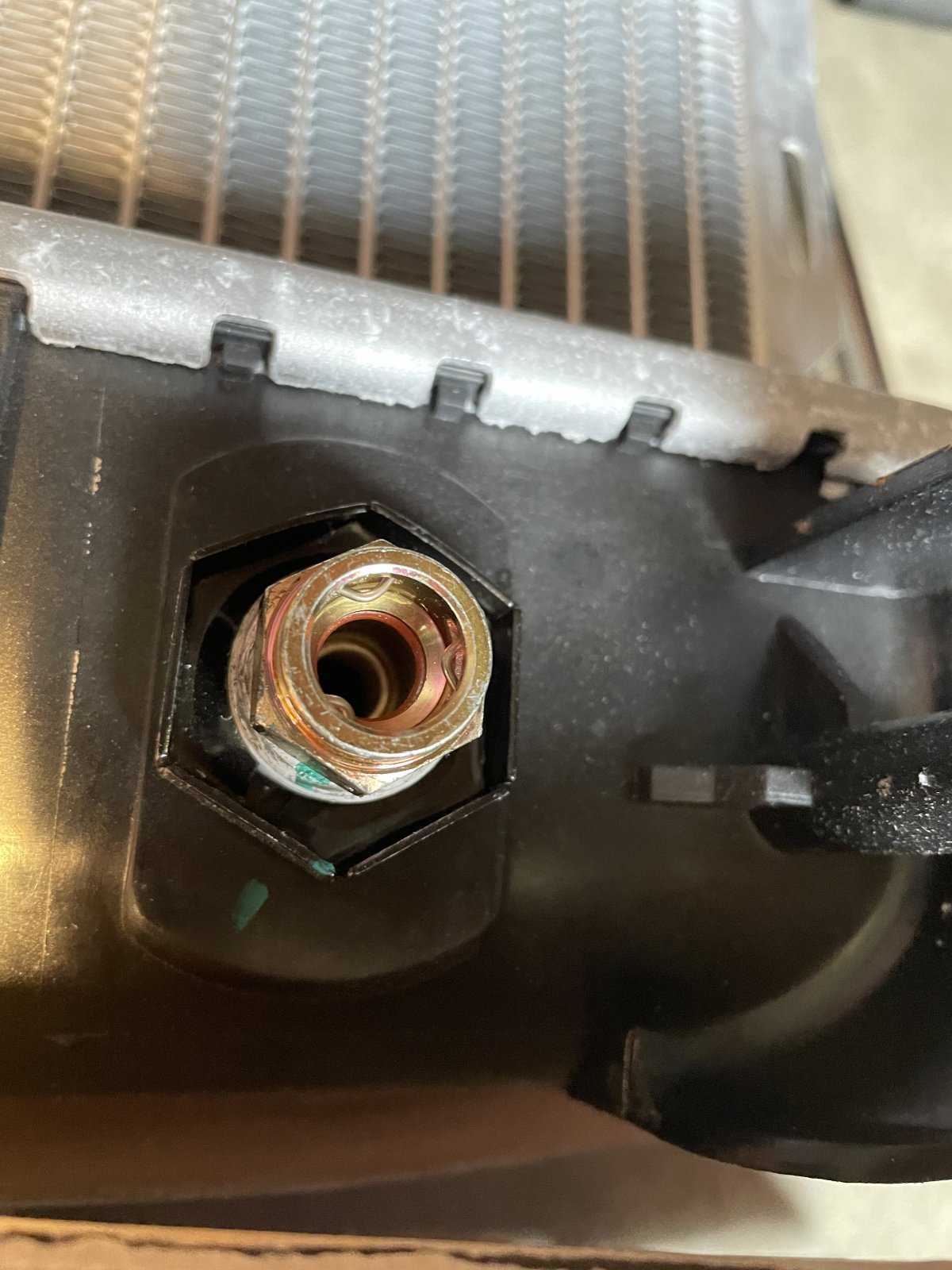

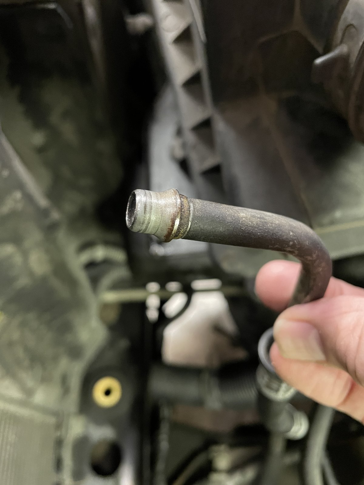

Taking a second look, there’s no evidence of an o-ring on the transmission cooler line side of connections, but both the new and old radiator fittings do have o-rings imbedded deeper inside the fittings. Looks like the black ones provided may not be necessary(?). The first pic is the trans cooler line. The next one is the old radiator connection (black o-ring is barely visible down inside) and the last is the new. A brown o-ring can be seen in the new connection. Perhaps these 2 loose o-rings provided (not pictured) are for the oil cooler connections, which I don’t have.

The brighter fitting came with your radiator, right? I seem to recall the last radiator I replaced had the fittings in the box, I just had to screw them in. If that's the case, you are golden. Just pop the lines in.

The O-rings are inside the fittings, not on the lines. I'm guessing the loose O-rings are either extra or they need to be installed into the fitting. I've never had to replace an O-ring inside of one of those type fittings, and when I've bought new fittings for when I added an aftermarket cooler the O-ring was already installed.
