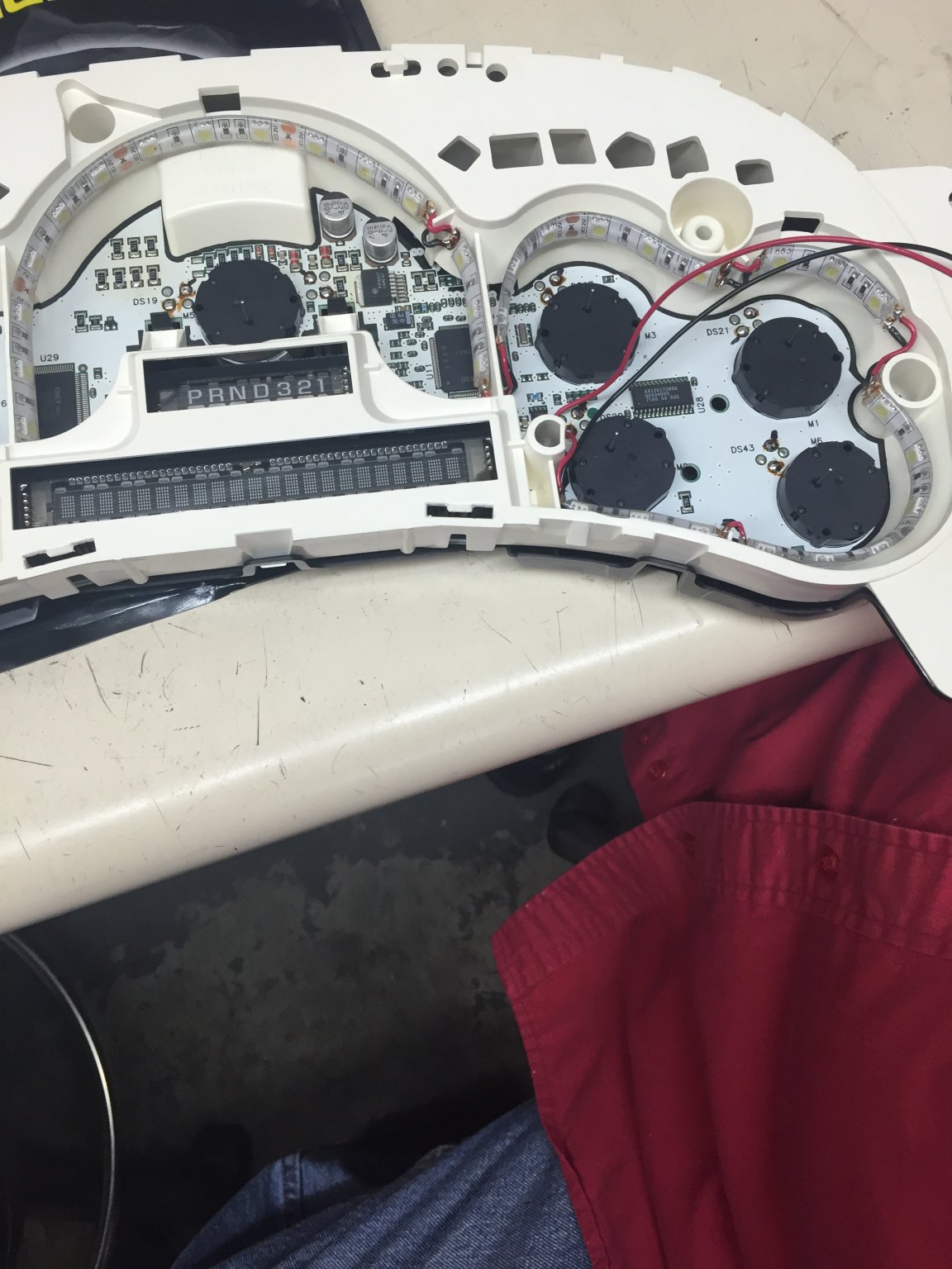

Uh yeah! Where did the White Face Gauges come from to start??
And this bit "LED white stripe lighting for my gauge lighting." What's the deal there?? Details please. :)

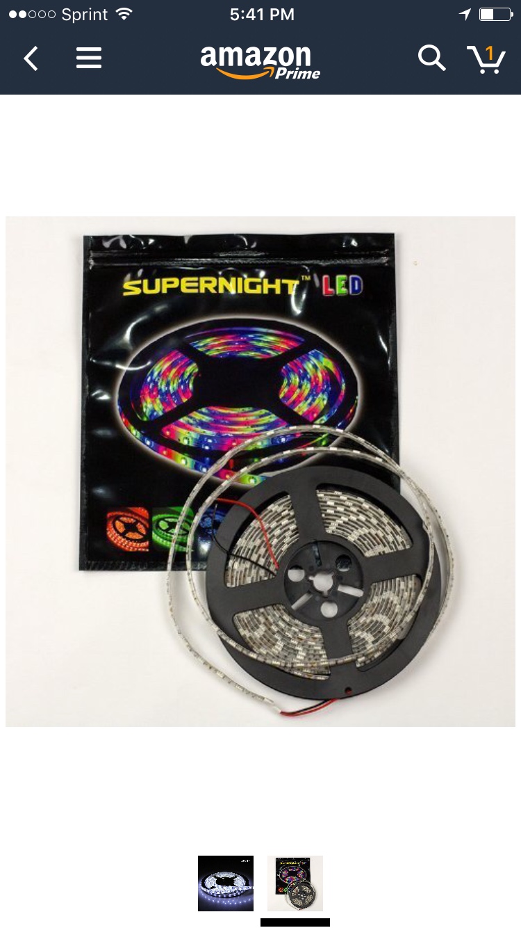

Believe I purchased both the gauge face & lights off Amazon. Soldered in all new steeper motors (7 total).
LED stripe was a bit tricky. I cut it off in sections where is was able to stick to the plastic backing of the cluster. Then I soldered it where the bulbs would connect. I'll have to look for additional pictures of when I completed it. But here's the parts I purchased.

When I did the bulbs they required resistors. Without them you can't dim the bulbs with the dimmer switch. Can you dim yours?
