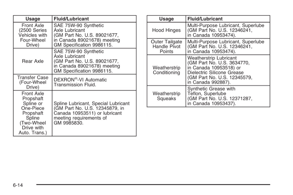

Well the manual also says Dexron VI. But I have the selectable dial selector.
So that's what's confusing me.
Here's what's the manual says and a picture of the switch.
Again, I may have misunderstood, but Auto trak II was for the this type of selectable switch and Dexron vi was for AWD with no switch.
Thanks
Farhan
Looks exactly like my 2011. Manual wasn't very helpful and I became worried about it after reading some posts here for Autotrak II since I just changed with Valvoline MaxLife ATF. Well, just spoke with the local dealer who says they are calling for Dex VI.
