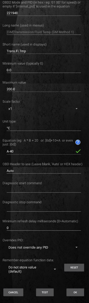

Here's my gauge configuration for reading from my '05
