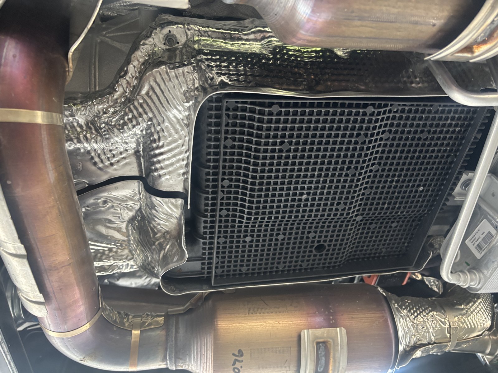

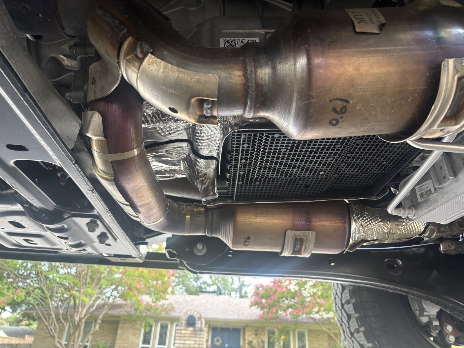

Our 2024 Suburban towing ~7000 lbs for over 3-4 hours... ambient low 90s... the highest I ever saw it go was 169F.
The Ford 10 speed employs a plastic oil pan (good job Ford saving $$, lol) not sure if that is why but there is a lot of shielding around the pan and over the exhaust pipe.

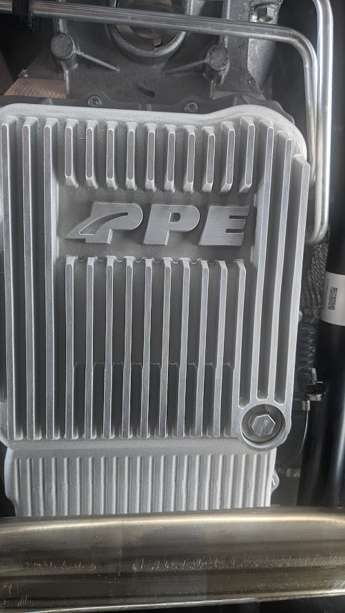

At least on your Ford, you can drop the trans pan with the exhaust in place. I would be swapping the plastic pan out with a PPE or some other aluminum pan by 20k miles just because. Something in the road could easily bounce up and crack that pan and the heat will get to it at some point as well.
At least for the 5.3l and 6.2l 1/2 ton 4WD GM trucks and SUV's the drivers side exhaust crosses over under the rear edge of the trans pan and this pipe is POST Catalytic Converter so it likely is VERY hot while cruising. GM stuck the converters up very close to the exhaust manifolds, it will be interesting to see how the under hood plastics and rubber is in 10 years after driving. The BMW's with the converters hanging on the exhaust on the rolled over straight 6 cylinder had so much under hood heat the plastics and rubber were compromised by year 8 and by year 10 they were really having problems.
Picture of PPE pan installed on my 2024 Yukon Denali, you can see the exhaust cross over at the bottom end of the picture, it is not a great shot, but it gives you an idea how close the pipe is, the pipe is even flattened out to save space. Maybe 1 1/2" clearance between the top of the exhaust and the trans pan. The heat shield may not do wonders, but it can't hurt IMHO. We shall see if I detect an improvement. I will not have enough data to tell if the change is subtle.

Yes it does look like the pan can be dropped with relative ease on the Ford. I recall having trouble on our 2018 Tahoe with the 6 speed. The driver side pipe fought me. I had to pry it away with ratchet strap and 2x4 on the subframe and managed to pull the pan out. On our 2024 it’s the same flat pipe deal as yours. That pipe is too flat for my liking. At some point I want to run my IR temp gauge on it. I expect it to be a restriction and should see a sharp temp difference before and after.
Yes, I’d like to swap the pan to metal at some point.

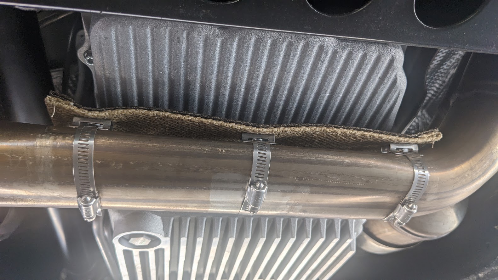

Added the heat shield mentioned in my post above, seems to fit fine, but very close proximity overall. Hopefully it will help with radiant heat transferring to the trans pan from the Post Cat drivers side cross over pipe.
