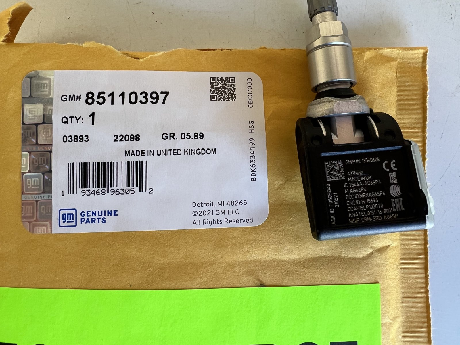

FYI, picked up the TTPM yesterday, note the P/N on the sensors which were in the kit w/ P/N 85110397 are 13450608
