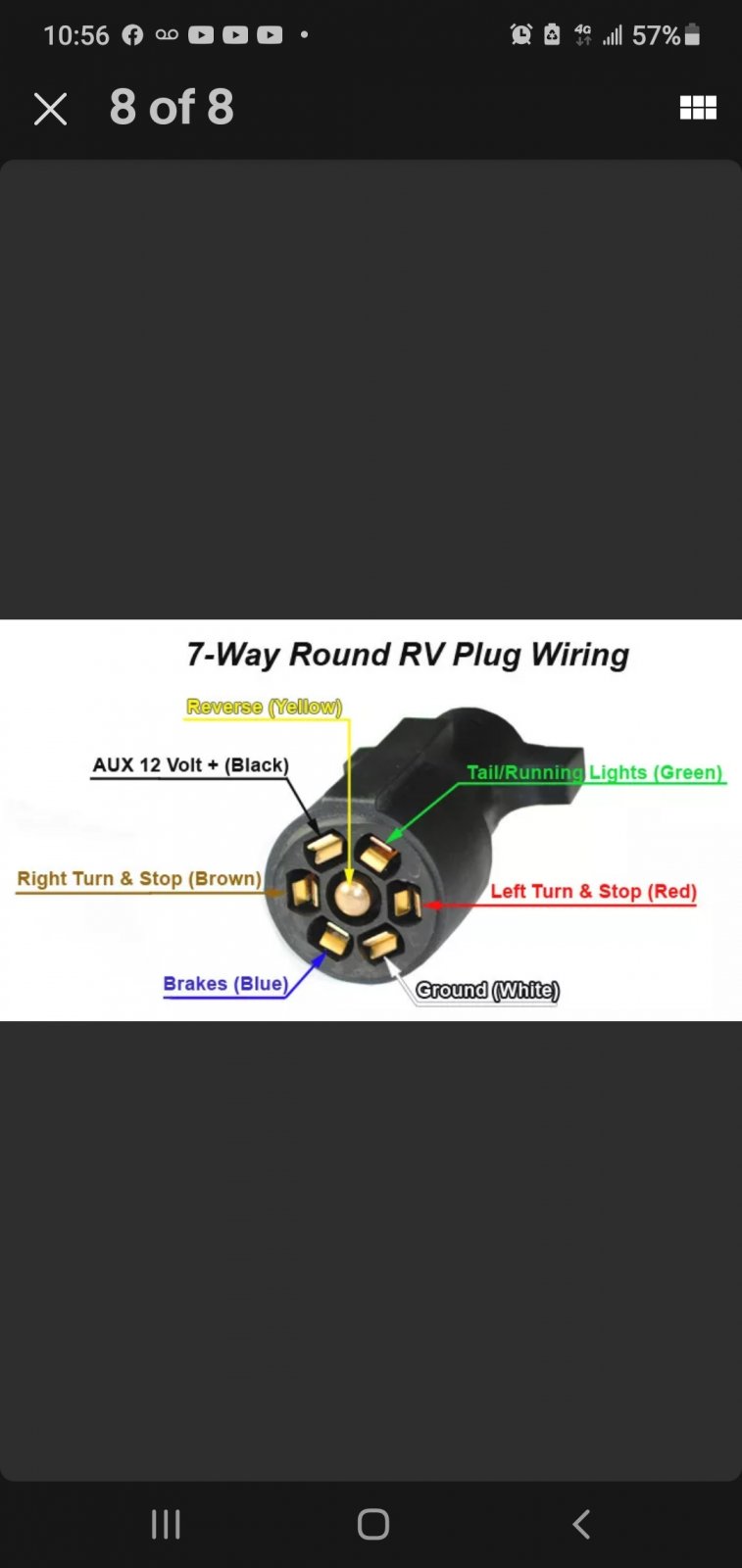

What does the dealer need to do to get my trailer lights Goin, I check book here's what I found

Yes I have the Socket, there no power there

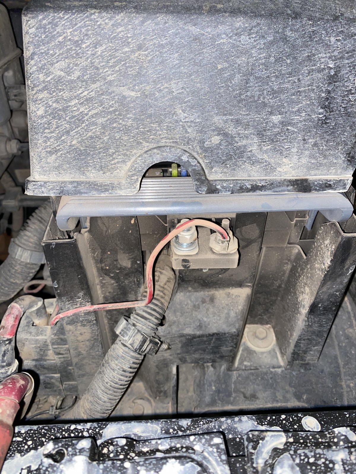

Oh that’s simple. There is a coiled up wire taped to the side of some wire harness below the master cylinder. The wire needs to be connected to one of the terminals on the front side of the under hood fuse panel.

I thought the wires you are talking about are only for trailer brakes and aux power to the trailer. I thought the trailer lights were already active.
What Fuze is it please I already left the truck at friends
In the fuse box under the hood:
Fuse 3 & 6 are your Trailer Turn/Stop lamps
Fuse 10 is your Trailer back up lamp
Fuse 24 is your Trailer Park lamps

Yes, the lights should be active.

Told my buddy, he found the wire! Really corroded, fuzes r good, anything else I need to know lol

It would be worth it to double check the wires going into the rear of the socket by the hitch as well as maybe take some emery cloth or fine sand paper and clean off any possible corrosion on the connectors in the socket. You have a 13 year old vehicle so who knows what condition your wires are in.

If you need electric trailer brakes.
mine doesn’t have any due to weight, but I definitely wanted the power.
I don't have a trailer that has electric brakes,
So I'm pretty dumb do I find these wires under dash and run them down or do I just connect the 2 under hood I'm good,

You have to connect the brake control wiring at all if you don’t need it. Just do the power.
