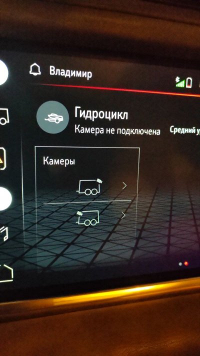

Hi all. In our Trailer Section we have this section. Trailer cameras. Judging by the picture, these are cameras that are installed on the sides of the trailer for monitoring or maneuvering. But I didn't find any information in the accessories. Does anyone know how to use this section?

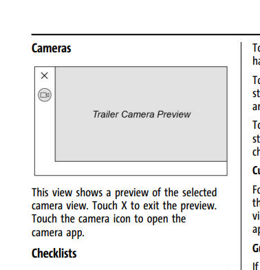

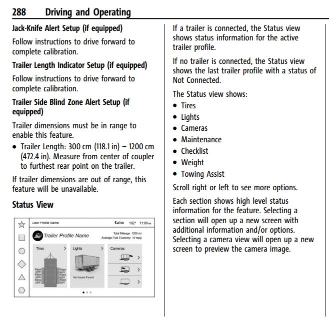

Unfortunately, trailer sellers don’t know anything about this, this is the Car section. Here it is listed in the Yukon Guide. At the same time, the section about cameras is generally empty.

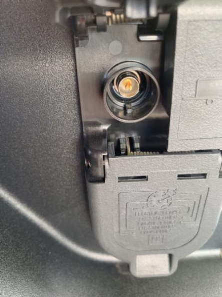

If you have the Enhanced Trailering Tech pkg (ZM1) - then just above your 7-Way connector you'll have two inputs for cameras. Like this -
The camera is available through Chevy/GMC accessories and looks like this - https://www.shopchevyparts.com/elec...mera-models-with-zm1/86584184-p-92317975.html
If you don't have the ZM1 package, then you won't have those inputs and the feature can not be utilized on your Yukon.
What year Yukon is that off of? I have a 2022 with the Enhance Trailer Package but I don't have those inputs above the 7 pin.

What kind of cameras are these? :) how to find them and where to connect them? I don't have such connectors)

Do not just buy the cameras if you do not have the inputs above the 7 pin wiring harness.
This Enhanced Trailer View was an option, contained in the ZM1 Enhanced Trailering Tech package. It enables "Disappearing trailer" view, and using the trailer outside came for being in reverse when you have a trailer w/ a camera hooked up. But, if you don't have the support on the vehicle (including the inputs), you don't have thse features. It was my understanding that if the sortware on the dash is enabled, then you have the connections, but check your trailer wiring connector first...cameras are useless w/ out the software and the connection.
