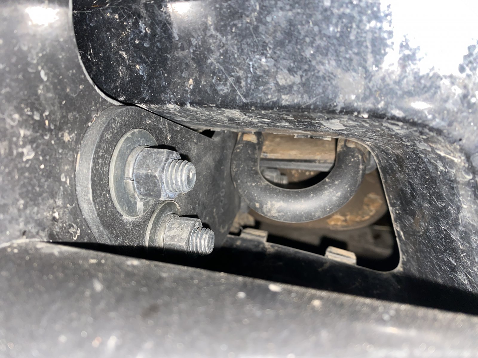

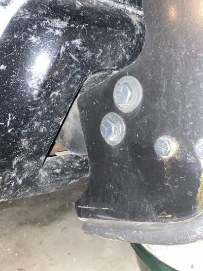

@Matthew Jeschke @Doubeleive The tow hooks work fine, just with a soft shackle instead of d rings to attach.
I just realized I hadn’t looked since adding push bumper. Doing that required removing the trim around the hook. I tried the d ring again, but no it still doesn’t.

ya that would be in the way in which case I would just attach to the brush guard nearest the mount

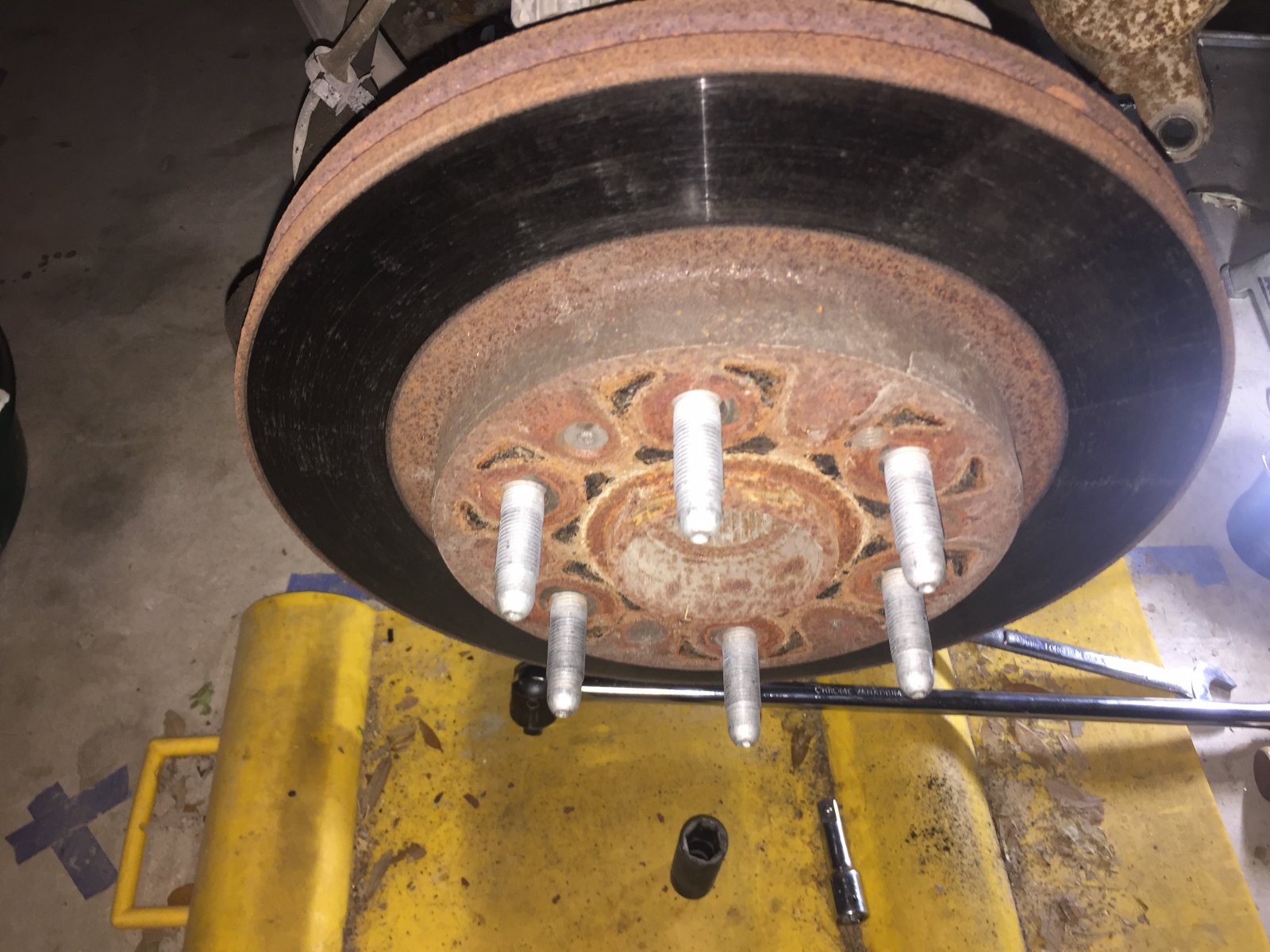

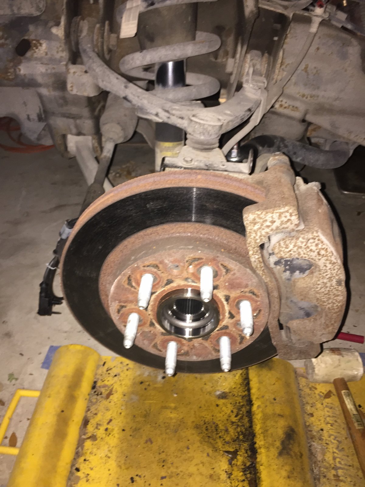

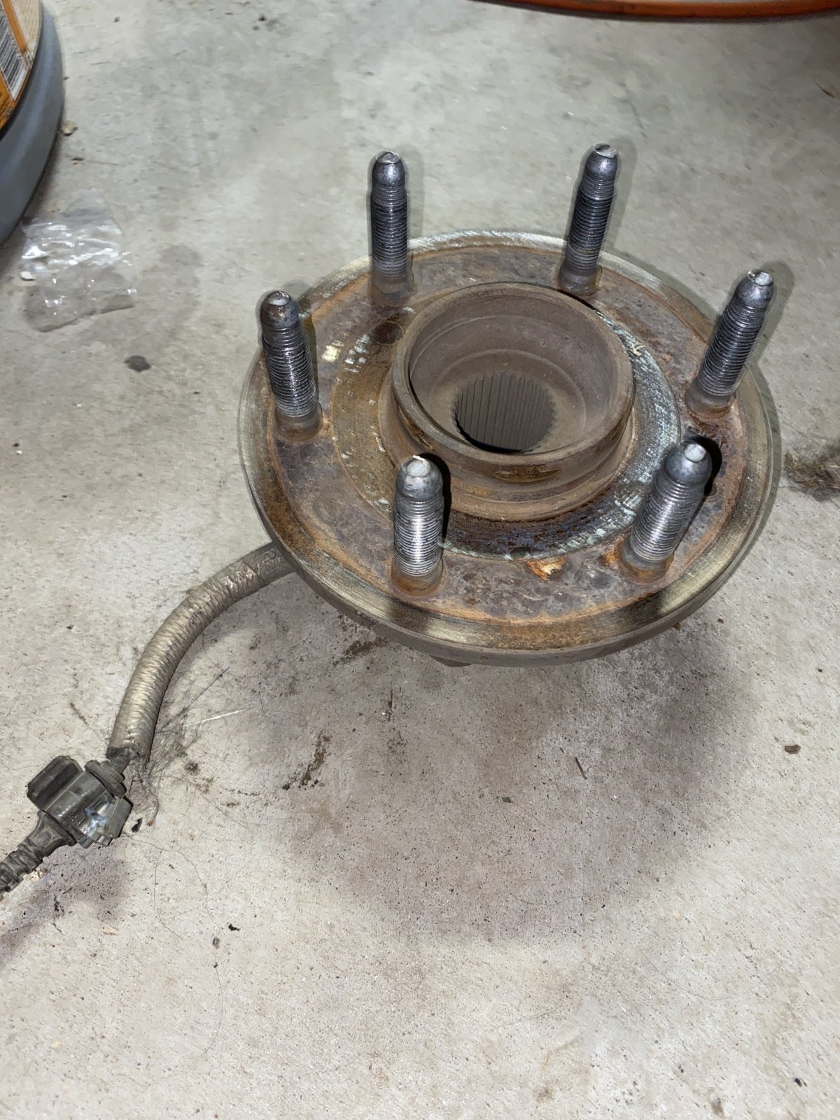

The hub is bolted in to place on the spindle and at that point, if a tire and wheel is attached, the only thing holding that all together is the wheel stud plate pressed in to the bearing.
When the axle is added, the front of that cv joint is stepped in such a way that it seats into the back of that bearing race and then the nut on the front presses that wheel stud plate into the bearing and does not allow the hub wheel stud plate to "walk out" of the assembly.
I don't think the "wheel stud plate" is the correct name but you get my drift. If a 2wd hub is used, I believe the plate is held in place, at the back side, by something along the lines of a big thick c-clip or cir-clip or whatever.
It makes sense that if a 4wd hub CAN BE USED in place of a 2wd hub, that there is likely a clip at the back of it as well to hold the wheel stud plate and keep from walking out. The size and thickness of the clips for both hub assemblies may be different for each application.
Or, I am completely wrong.

I used to think that was a universal rule coming as I did from Jeep. Then I read the reports on here of the 2WD trucks using the same unit bearing we are. Perhaps some of those guys with direct experience will chip in and comment. My understanding is there’s only one part used in 2WD and 4x4 front ends.
Both of the twins had 4wd fronts hubs originally, and still do after I replaced them.

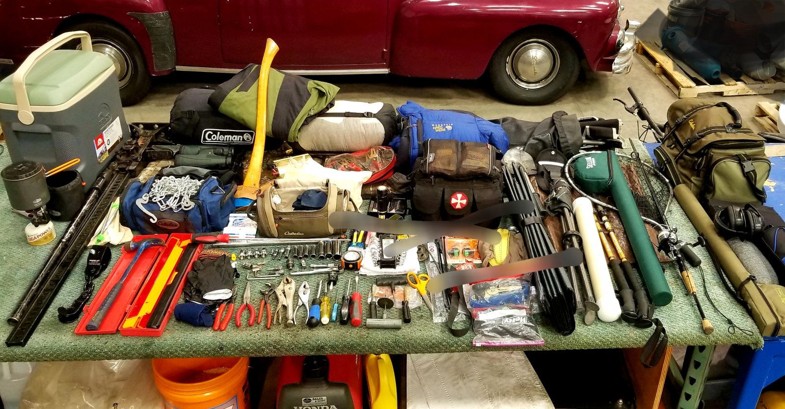

This is an old photo of my tool kit. Since then I have added a 1/2 inch impact wrench, a Fluke multi-meter, a small plastic box with extra bulbs for every light in the truck and a lot of elect repair and misc repair items, a few larger sockets. I have onboard Air two ways CO2 tank and compressor. I can hook up all four 35's at once to air up or down in under 5 minutes. 7 Gal water. extra motor and trans oil. The camo pads on top black out the windows there are enough to cover all side and the rear window.
All of this fits under my rear rack system along with 7 days of food and other comfort gear. I have a much larger trauma bag now too. This is my daily driver and at anytime it is good for at least a week in the wilderness... Other stuff not shown is ammo and a few firearms and my cooking kit.
Here is a video with a little more detail of what I carry...
