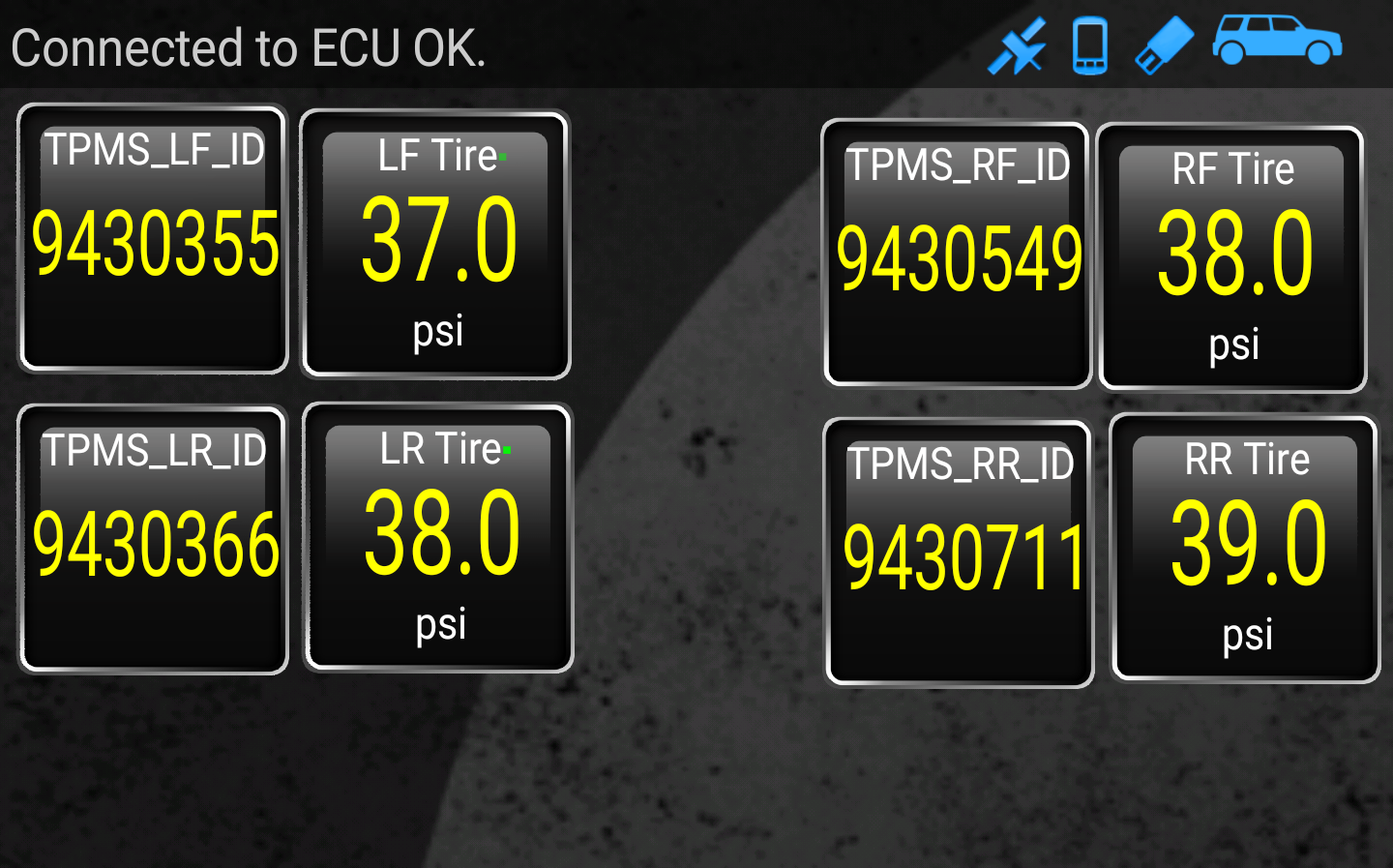

Here it is formatted so it is more readable:
Recent thread about TPMS reminded me of this so I thought I'd add to it. Not that I think anyone is going to need this but you never know.
Edit:forgot a pic...

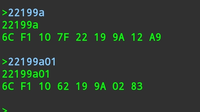

Sorry for bumping an old thread, I'm just hoping you are still here. How did you search for the PID's? I'm trying to add these to my T1 Silverado, but the PIDs you have don't seem to give me data. It will occasionally give me 255 or 0. I also tried removing the header and leaving it at auto. That didn't seem to help either.
Realize I am late to the question here. I have been away from the forum for a while.
Anyway, try adding "01" to the end of the mode&pid you show. So the one you pictured becomes 22249101. An "01" seems to be required a lot of the times when a PID gets no response or a "7F...." response.
If that doesn't work there may be another way altogether to get the data using Torque Pro.
edit: and now I see the user hasn't been seen since the time the question was posted long ago. Maybe others might still find it useful though.
