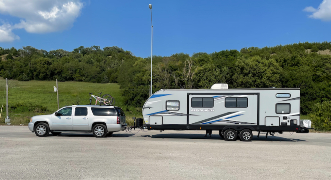

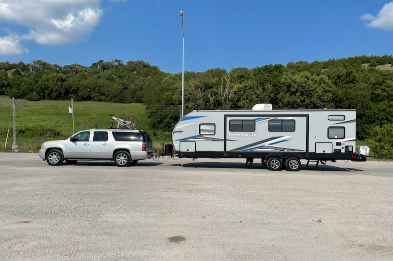

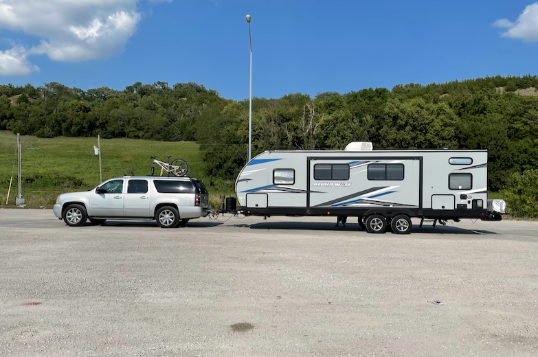

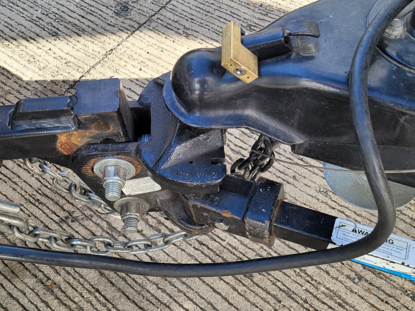

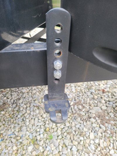

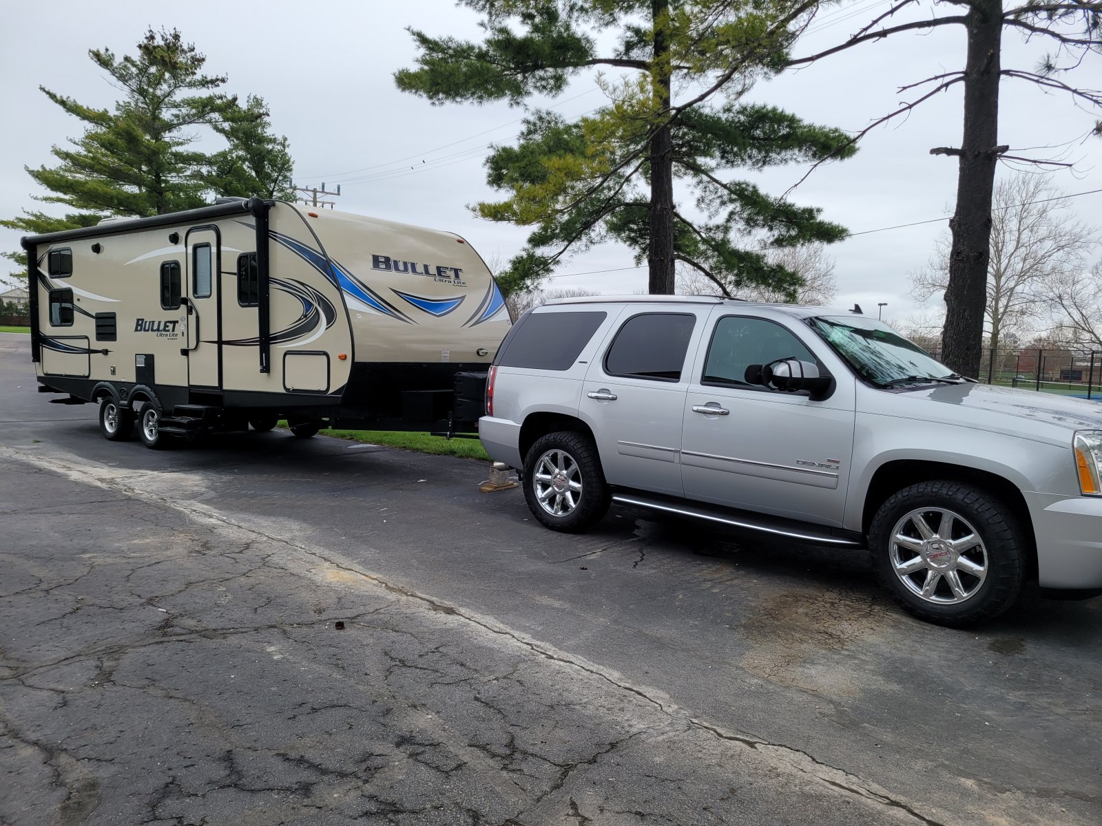

I have a 2014 Yukon with air shocks, and am towing about 6000lbs. I started with a 15,000lb weight distribution hitch. This hitch came with brackets bars for anti sway. Still lots of sway!
I was high on the ball but both SUV and camper are now level. New lower shank. I added a curt anti sway bar and have locked the shank to the car receiver. I still get lots of sway. Is anyone else towing this much weight and what is your experiences?

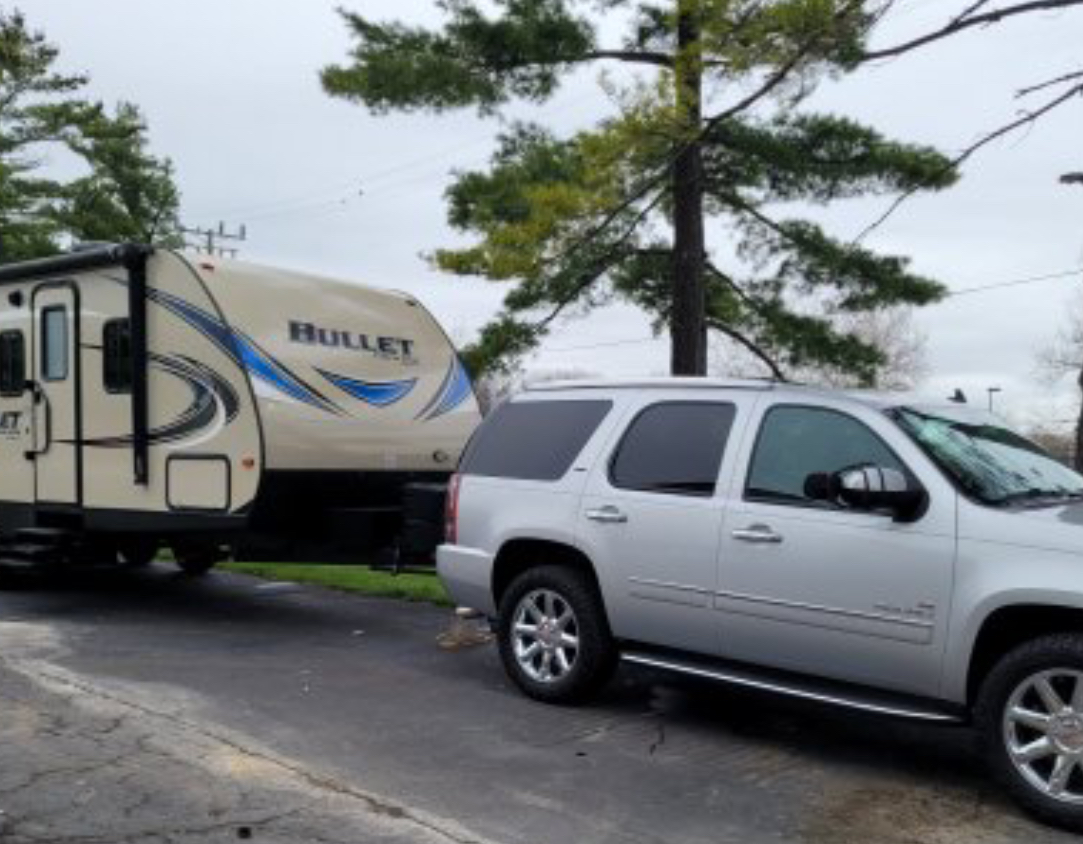

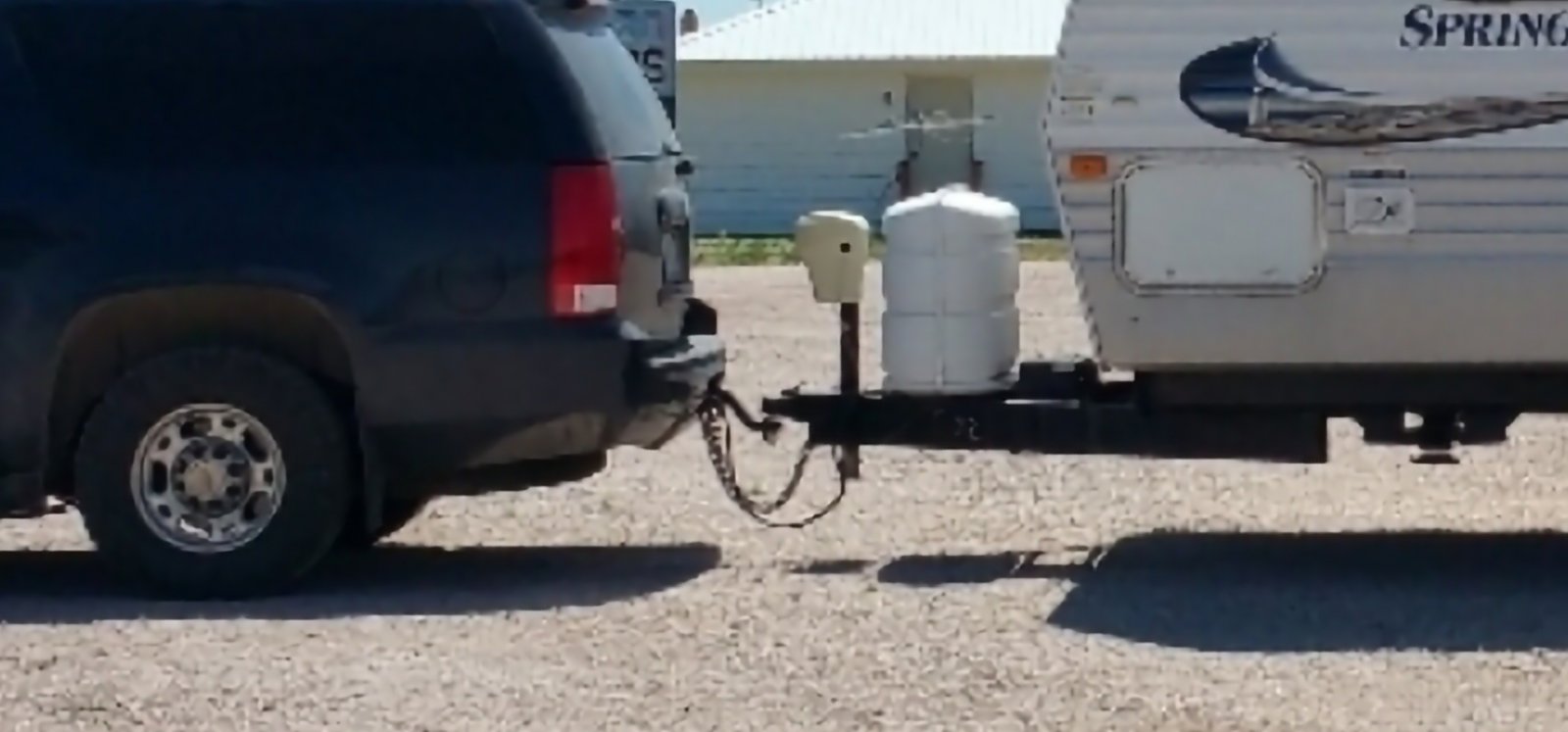

Is the 3rd picture with the "new lower shank"? If it is the camper looks a little nose high. It could just be the angle of the picture, but if it is nose high that will also induce sway.

Is it time for Hellwigs? Beefing up the sway bars would increase the comfort in the vehicle and ride quality when towing.
Good looking truck & trailer.
We are almost perfect level after I installed the new shank. This photo is on a small hill lifting the back of the Yukon up.

I do have anti sway, WD hitch. And it's an Equal-l!izer. I can adjust the pressure applied to the bars by either changing the height of the brackets that hold the bars, or change the angle of the head to tighten or loosen. I don't think changing out my hitch will do anything, as I can change the pitch of my bars from overkill to zero pressure.
But. I will check this out. Thanks!

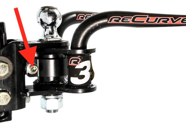

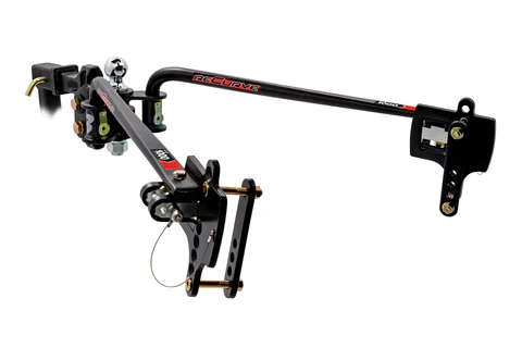

I'll add my name to the list of folks suggesting that you probably have too much hitch for that trailer. If it's helpful, this is the hitch I have (with the same 1000 lb. bars). The sway control is under the ball and you tighten the Allen bolt in the picture, which clamps down on the swivel with brake friction material, to get however much sway control you want. The advantage to this design is that it's fairly light weight, doesn't require drilling the trailer's A-Frame, and you don't have to disconnect or release the sway control to back up, as with some designs. I like the designs Foggy mentioned as well, so just wanted to share what's working well for me. This one has been a set it and forget it solution. I've seen a lot of them around and so far everyone else has been happy with their R3, too.
I'll also second James' suggestion of going to a CAT scale to get the weights. I measured mine 3 ways: 1/ Just the Yukon 2/ Yukon with the hitch and trailer connected for towing, including the WDH bars. 3/ With the hitch and trailer connected for towing, but without the WDH bars installed. That gives you everything you need to know exactly how much weight you're redistributing with the hitch.

That's an interesting set up. Not seen that before. I'm trying to figure out how the bars move on the bracket.
That's the thing - they don't need to because where the front of the bars mount beside the hitch ball pivots, allowing the bars to stay in fixed positions on the A-frame. The sway control acts on that pivot point. It's pretty slick.
I like this. I wish I knew about this before I spent the $500 to make my old hitch work better.

Wasn’t paying attention. I thought I saw a standard
length truck and then it’s an XL with a trailer that didn’t look that big in the first pic. :D
