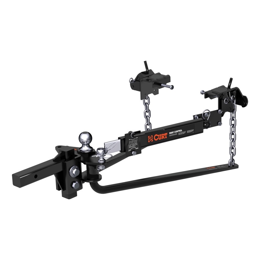

The weight Distribution hitch has a "special" hitch that slides into your receiver. The hitch has built in adapters that receive torsion bars that extend to the tongue of the towed vehicle. The towed vehicle tongue will have receive adapters that are a part of the WDH and come with the WDH. These adapters clamp to the the tongue over half between the tongue ball receiver and the front of the actual camper. So about 4ft behind the tongue ball receiver. The adapters attach to chains that are mounted on the end of the torsion bars. As you adjust the tension on the chains by putting a certain link of the chain on the hook of the adapters and then lock down the adapters this causes the torsion bars to take on weight and lift the tongue of the towed item up which transfers weight OFF of the towing vehicle and onto the axles of the towed item (camper). This greatly reduces swaying and chance for a jackknife situation. Attached is a picture to help it all make more sense. @Fless

Yes, I've used them before on larger campers. Not sure if the one I'm renting will have the WDH but if it does, I'll use it. The two campers the guy has to rent are identical (he says) except that one has the WDH and the other doesn't. I know enough to have good tongue weight and having the camper level or a little nose down to prevent sway as much as possible. EDIT I guess I already said that.
