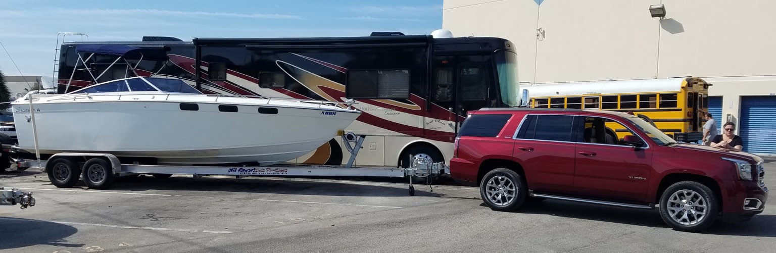

I tow a 7500# 26' Formula Boat with my '16 Yukon Max Tow 3.42 gear 2 Wheel Drive. I am set up with a 600# tongue weight and have no issues what so ever. The total package works very well. My previous vehicle that I used was a 6.0 LQ9 Escalade with 3.73 gears...surprisingly the Yukon does a better job !!
