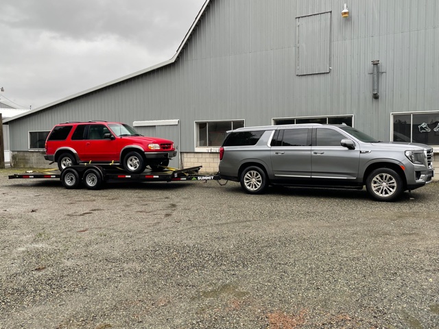

I've towed one time so far with our '21 XL with regular coil shocks and it's pretty obvious that these rigs will need some kind of air bag/helper spring. I towed a 2 door ford explorer sport on a 10k tilt deck and the sag was pretty obvious. Plenty of power and stopped just fine (even though I have no max tow or even a trailer brake controller) but the sag is real...
Unfortunately, I don't think either of those options change the spring rate which is the problem here. With a IRS design, I think there are limited locations where an aftermarket company would be able to implement an air bag.
How much do you think a WDH would have helped in your case?
doesn't look too terrible at least. We picked the max tow option with the 6.2l. I think with a good WDS we should be ok.......I hope
