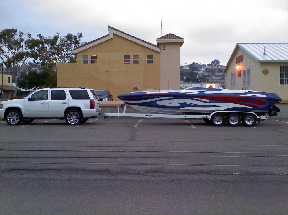

I have a question regarding towing as well. I have a 2011 Tahoe LTZ with the towing package. I just bought a 26' Cobra Razor with a triple axle Extreme trailer that im picking up in about 6 hours. The weight of the boat and trailer is going to be about 5800lbs.
My tongue and ball is adjustable and rated up to 10,000lbs so im not worried there. On my Tahoe the tow rating is 8,200lbs so i know im within limits there as well. My question is: On the hitch that came with the Tahoe it states that maximum towing capacity is 5,000lbs and 10,000lbs with a weight distributing hitch. The boat trailer is NOT a weight distributing kind.
Im wondering if i will be ok with the hitch thats on the Tahoe since i will be about 800lbs over what it states even though the Tahoe is rated up to 8,200lbs.
Opinions, comments, ideas????????

SmallXL: Ya i will be fine. I towed it back to my house in San Diego from the Inland Empire when i bought it and it did just fine. My concern was the same GrgKng's had about the hitch only being rated at 5,000lbs and my boat and trailer weighing in at about 5800lbs. which is about 800lbs over the stated load capacity of the hitch itself. Ya i will do most of the towing out to Parker/Havasu from North County San Diego so there isnt to many hills...15, 215 to the 10 fwy then rice road all the way in pretty much. I used to live in East County San Diego and i always took the 8 fwy to the 95 to Parker/Havasu and it can be tricky going over the mountain pass but at the time i had an F-250 and was only towing a 21' Aftershock so it was easy.
I bought the boat used so it came with a triple axel Extreme trailer. The original owner got the upgraded triple axel instead of the tandem axel...why? i dont know, probabaly for the "bling" factor. That boat would have been fine with a tandem axel.
How do you like your Orion? I was torn between the Venom and the Razor as i have always wanted a cat but in the end i went with the Razor becuase of the room it offered and the familiarity i have with v-hulls.

Small: Ya im pretty stoked with the purchase. Just took it into the shop yesterday(San Diego Performance Marine) and should get it back sometime wednesday.
The taho does have the tow package so it has the trans cooler. Its also has the load leveing air suspension in the back cuz its an LTZ model. It tows the boat no prob but i will be sure to watch my temp heading over Chiraco. Yes i do most of my towing during the day so its scorching out.
Didnt know Rice Rd. was having construction done. I will deff stay away from it. I'll take the 10 to the 95 like you suggested, my first trip out to Parker isnt till Memorial.
Are you gonna be out in Havi for Desert Storm? I wish i could make it...deff next year though...and i will take you up on that offer!
