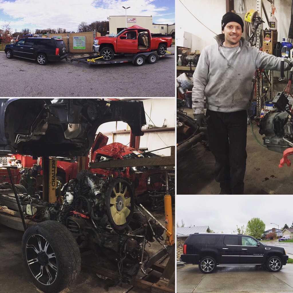

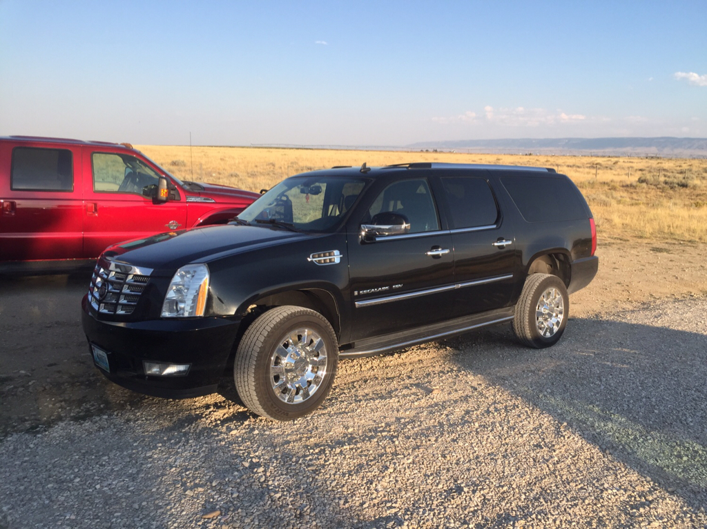

I have a buddy who is a contractor and frequently travels out to state and has to tow everything except the kitchen sink. He was a Dodge guy for a while but the generation he had compromised reliability for a loud, raw ride. He traded his 07 5.9L 2500 single cab for a one owner 13 Chevy 3500 2x cab (non-dually) LT with the 6.6L duramax long bed. It's equipped from the factory with integral trailer brake and Jake brake.
It has all the features and options you'd find in a Denali including the heated f/r seats as well as cooled front seats. It will pull stumps at 455/322tq. He just broke 200K mi on it and it's having its injectors and fuel pump changed at the moment. I've driven it with his 30ft pilot house Parker sporting twin Mercury 4 stroke beasts out back. You don't know its towing anything and the truck drives better when towing. Safe is the word I use to describe it when I'm in it.
The interior is identical to an LTZ Burb or Denali. It sounds like you're into a Duraburb or a 2500/3500 (3/4 - 1 Ton) truck as it's obvious you'll have more in tow than what's behind you.

This is one of my favorites
Wow...he was towing a 12,000# camper with stock 6.0 Escalades for years before he made the switch. 2,000# tongue weight plus 5 kids in the thing. I wouldn't do it, but I understand it. Thanks for the find, Michael. This is why I come here - to learn things I didn't know.
