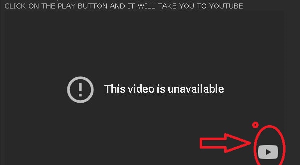

you buy this
then you watch this video, when you are at the workbench or dinner table, etc taking the lcd cage apart take photos of the disassembly process as the ribbon cables have to go back the exact same way.
CLICK ON THE PLAY BUTTON AND IT WILL TAKE YOU TO YOUTUBE

the video I linked shows exactly that, same as my wife's truck. that's why I said the ribbon cables have to be placed back the exact same way because the screen goes up & down.
her's was doing the same thing as what you are reporting
even though it says video unavailable just click on the play button (on the link above) and it will take you to youtube and play the video.

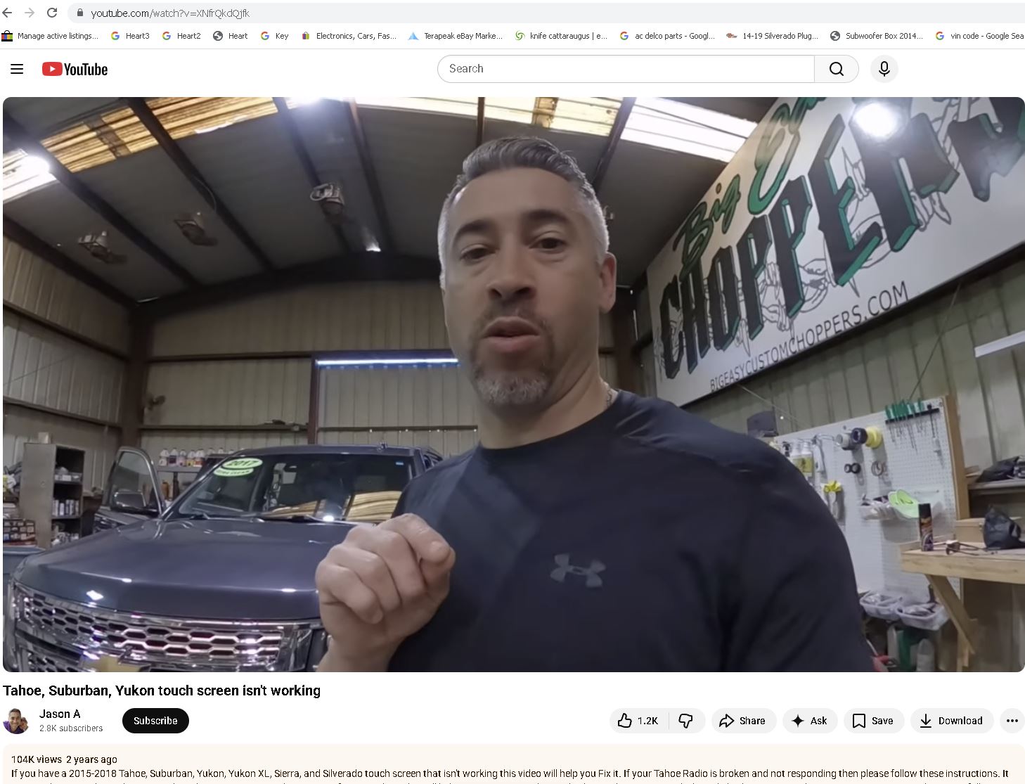

View attachment 476826View attachment 476827
That play button goes to YouTube's main page, not the indicated video.
See if this link will work (is this the right one?):

I just tried it on 4 different browsers and I am only signed in on chrome, all worked for me
anyway the title is pictured above by Jason A it's in depth enough to get the job done, except the final reassembly, which I would take photo's while taking it apart, it helped me to be 100% sure I did it right I didn't want it to self destruct on the first time it lifted up

By golly, that's it exactly. Looks like a real all day chore there too. Thanks for taking the time to get the link working! When I do this I'll put some lube on all those one way snap in retainers too, just in case.

Finally got a chance to work on this. Followed the video linked above (Thanks!) and it was exactly what I needed. Sure not easy to get those one way push in fasteners out. Screen and radio working fine, so far. How did we live without the internet?
