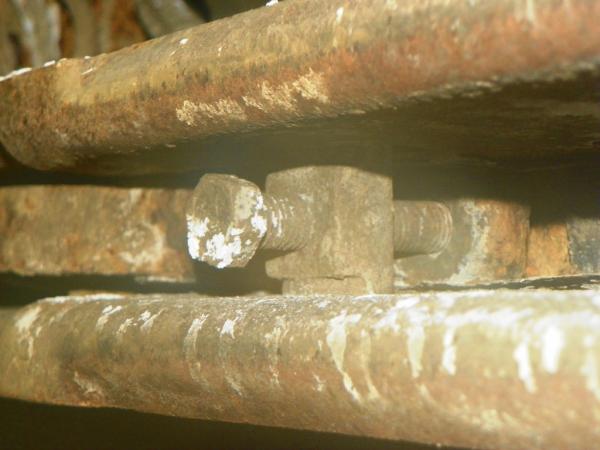

The short answer is:
Look under your truck until you see these bolts. One bolt for each side of the truck.
Shorter amount of thread left = higher/lifted ride.
Longer amount of thread showing = lower ride.
The long answer is:
There are other threads around here that give the exact procedures about adjusting TB's. Might need to use the SEARCH button. I'm too lazy to do it for you right now! :D

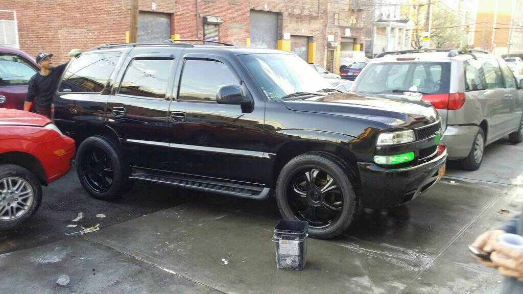

gettygatz4life
Apr 21, 2014
220
30
Bronx ny
I want to drop my 01 tahoe in the front just 1" so the back can seat up high and the front seat low what the cheapest way to go about this with out spending money
