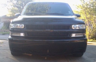

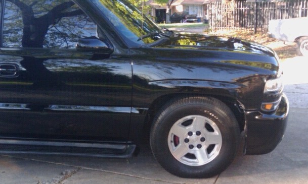

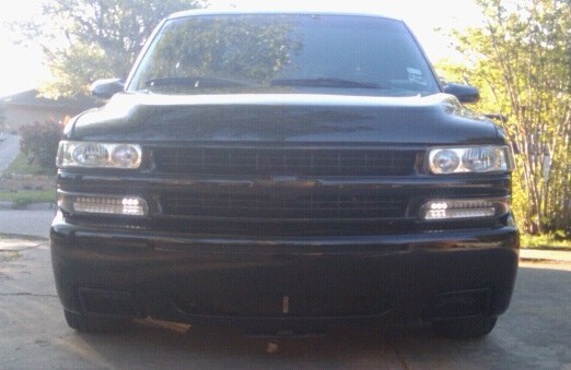

ok got it done.....turns out the Bars with the Yellow sticker Go on the Passanger side...and the torsion bars with the Blue sticker go on the Driver side.......i didnt even have to use the gear puller to throw in the New Keys....
the 1st time i threw the bars in ...the Keys pointed further down out of the cross chamber...resultin in them not bein pushed up high enough......which meant the Truck was Lifted more..........so if u want a LIFT just reverse the bars heh..
when i tried to lift the keys with the bars on wrong...i ****** up the threads on the gear puller....guess i now own the autozone rental..
thanx guys for takin the time to respond n help a bud out :Handshake:

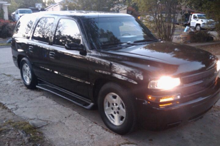

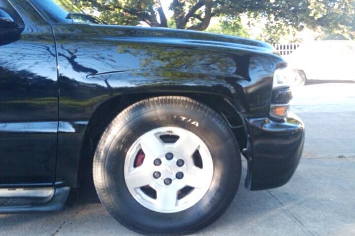

sweet sounds like you took care of it, hey robb do you mind posting a full picture of your truck just wondering what my tahoe will look with the stock oem rims, thanks bro btw truck looks good
robb.
robb.
Oct 10, 2009
65
dallas
sure no problem....i dont really like the way the 17 stock oem's look ..too small.......
i wanna slap some stock 20's on it...
