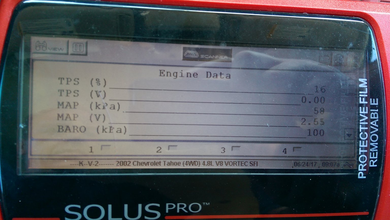

Ok, I've been forgetting to update my build thread. I had my trans go out. I only had 1St and 2nd gear only. Had a guy rebuild my trans. First he told me 2-3 days--2 1/2 weeks later I get it back. Shift kit, vette servo, Kevlar bands, etc, etc and I don't notice anything. Doesn't feel right, exhaust doesn't even sound the same to me. It feels like a stock motor to me! A gutless, noisy truck! Trans guy put the scanner on, and the tps is getting 0.0 volts. Of course he's never seen that before, and it shouldn't even be running. I'm at a loss.
I replaced the pigtail to correct the reduced engine power issue. So now I need to save some $$ and bring it to someone who knows what they're doing, and it's not gonna be cheap!
