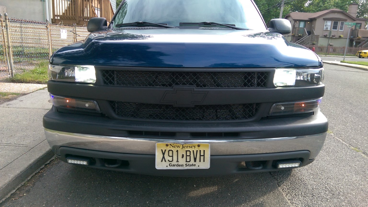

I drove on the highway today. I'm not really impressed. Motor doesn't seem as quick as before. I don't know what it is, or if I'm just imagining it. To me, something feels a little off. Just curious : he disconnected the battery, that wouldn't /shouldn't affect the tune? I wouldn't think so, but I just wanted to ask. I finally was able to install the high beam leds.
Can't get a night shot, it's been raining out.
