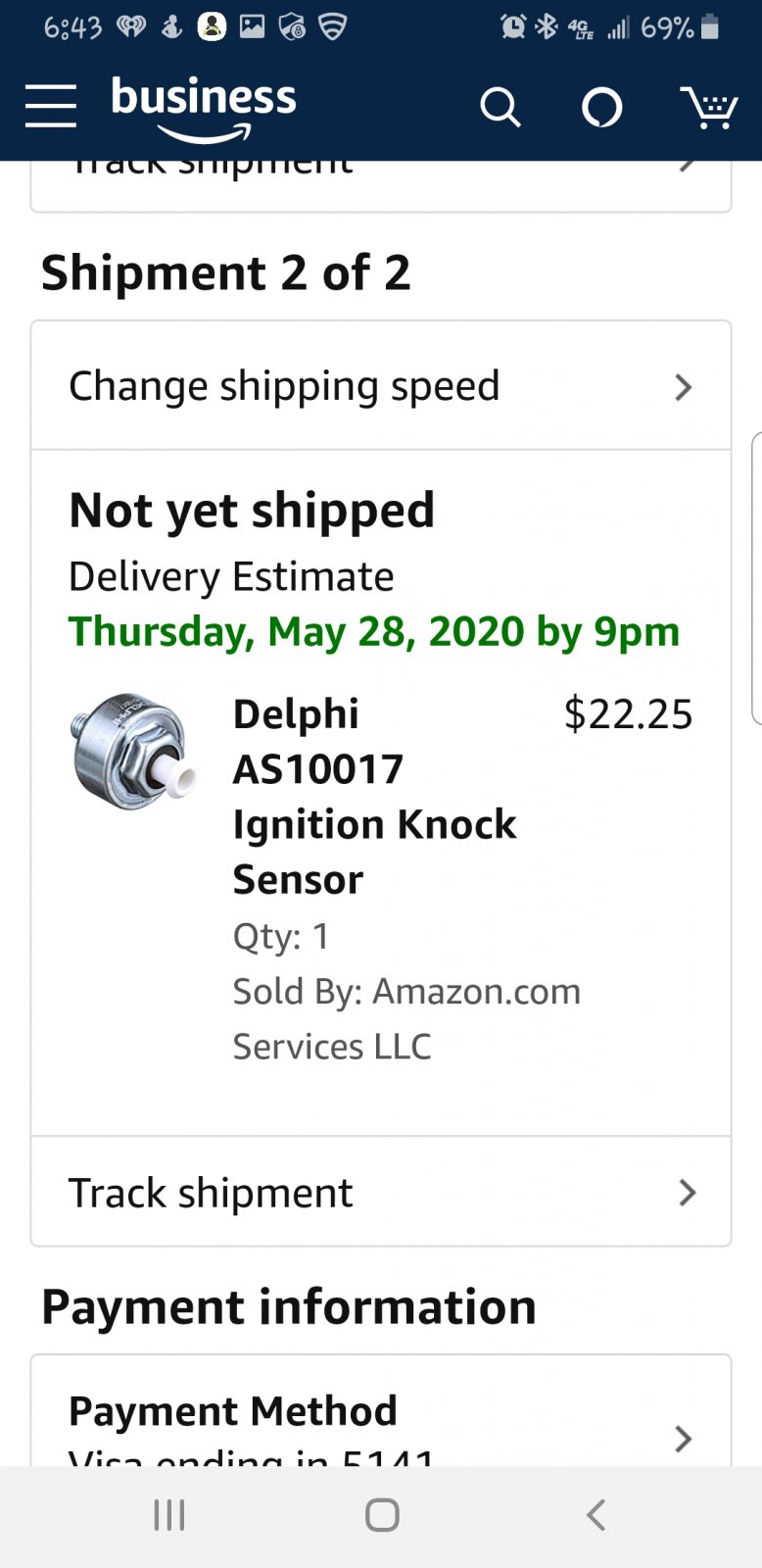

Hat to reorder the knock sensors. Got some Delphis.

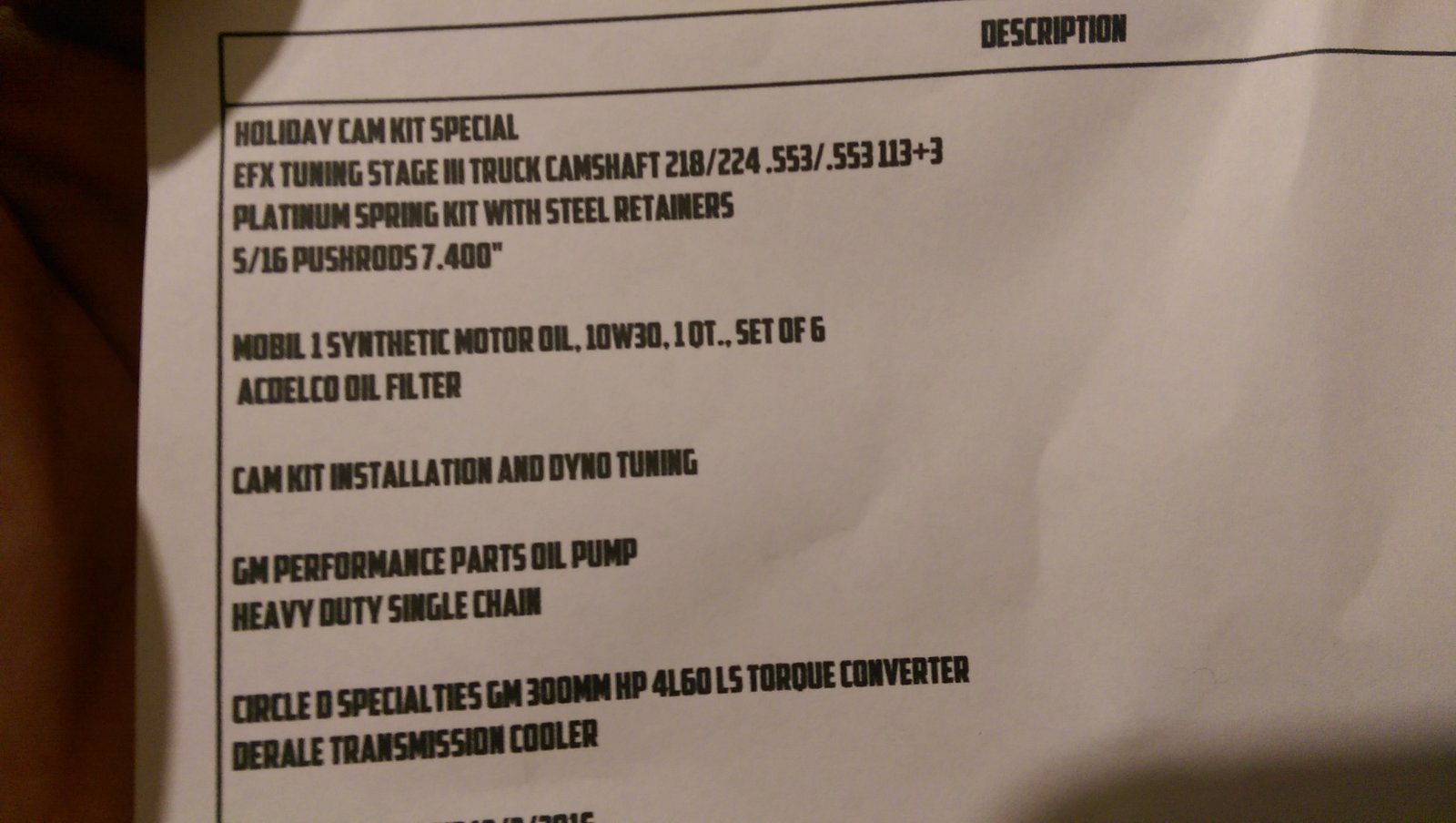

This is what was originally done to the 1st 6.0.
52,954
On the motor in there now? Don't think so. I know the chain was.View attachment 248148

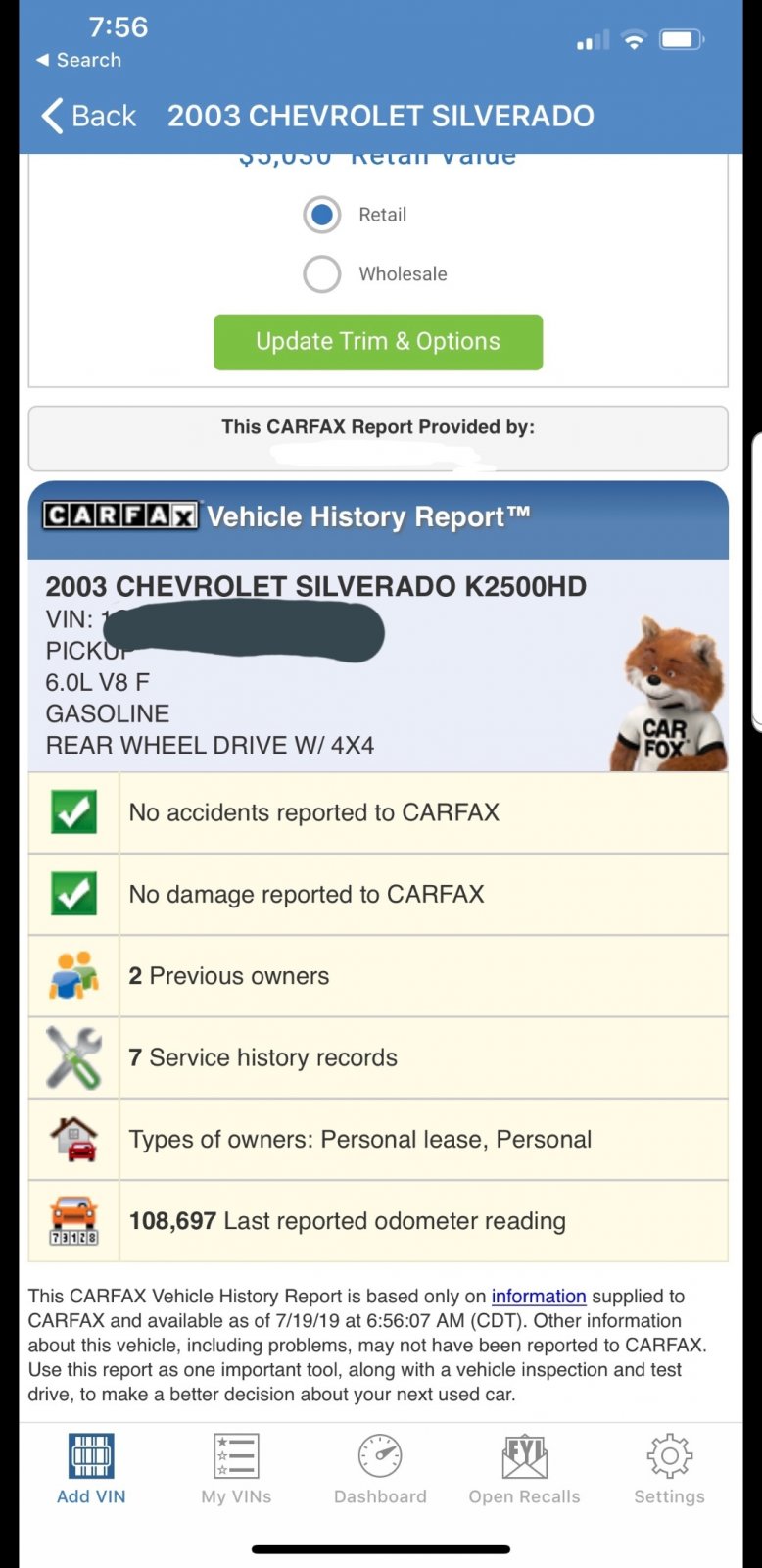

Well then I would have gone with the whole set since you’re in there. You don’t need a sloppy timing set. You should ask your buddy for his recommendation on this. How many miles on this engine that’s going in?
