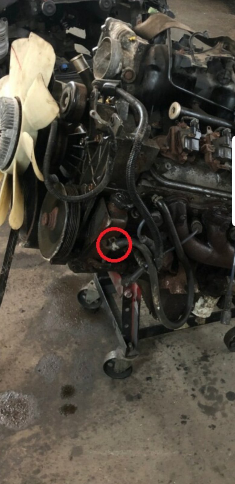

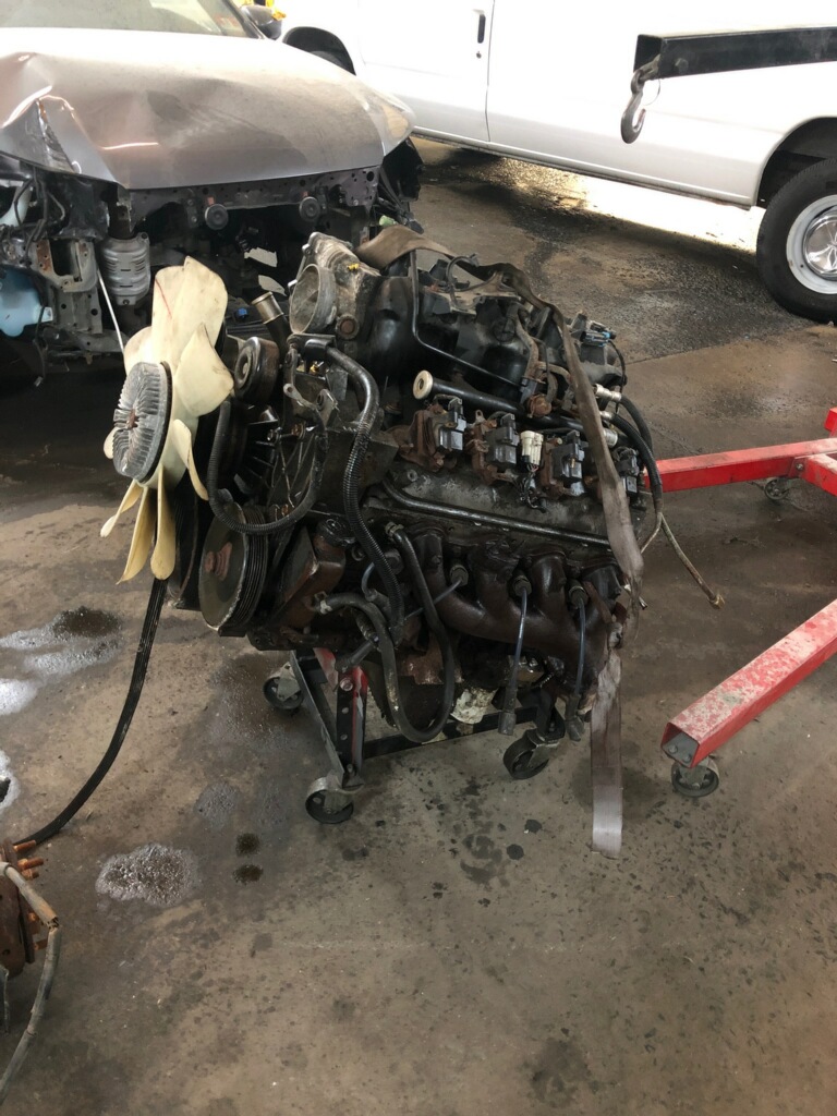

I think the new motor came from a Hydroboost Silverado. Debating if I should keep that pwr steering pump, or use my old non hydro setup.

I know for sure the difference is the return port on the reservoir. You could just cap it off if you wanted to. The pump may put out a little more volume, though. That I'm not sure about.

Yessir. Dis....
I know I've read it here, but what's needed uf I wanted to add hydroboost? Think I've read the brake pedal--along with the pwr steering pump--master cylinder too? My van has it and that ***** stops on a dime! And it's loaded with weight.
