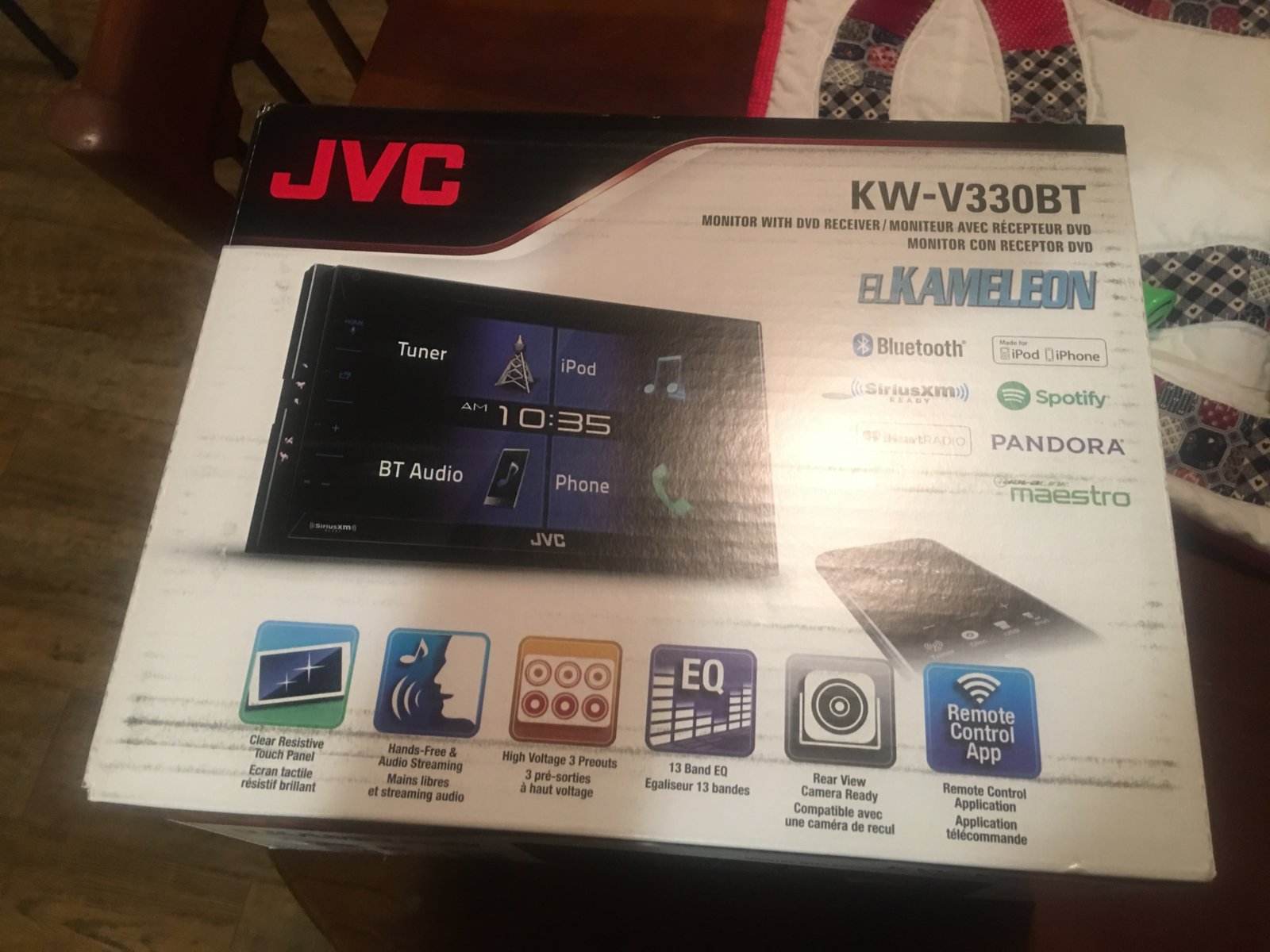

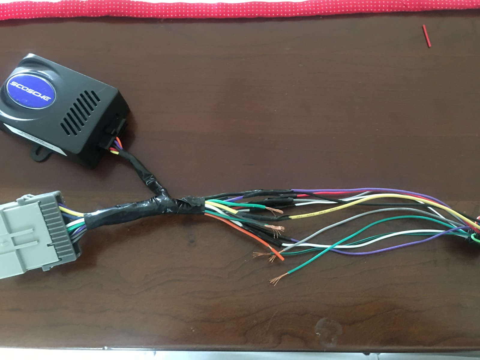

Maintenance got finished today. I also made a change and decided to go with a JVC KWV330BT headunit instead of Alpine. I picked it up today and did the install this afternoon. Only problem I had was Best Buy sold me the wiring harness for a Bose system ($140) and insisted it would work with a non Bose factory stereo harness. Nope, didn't fit. Went back to return it, then went to Walmart and got the correct harness ($40). Came back home, got everything wired up and working on the first go. I'll follow up with pics shortly.

IMG_0382.JPG Pic of the headunit after I got it home.

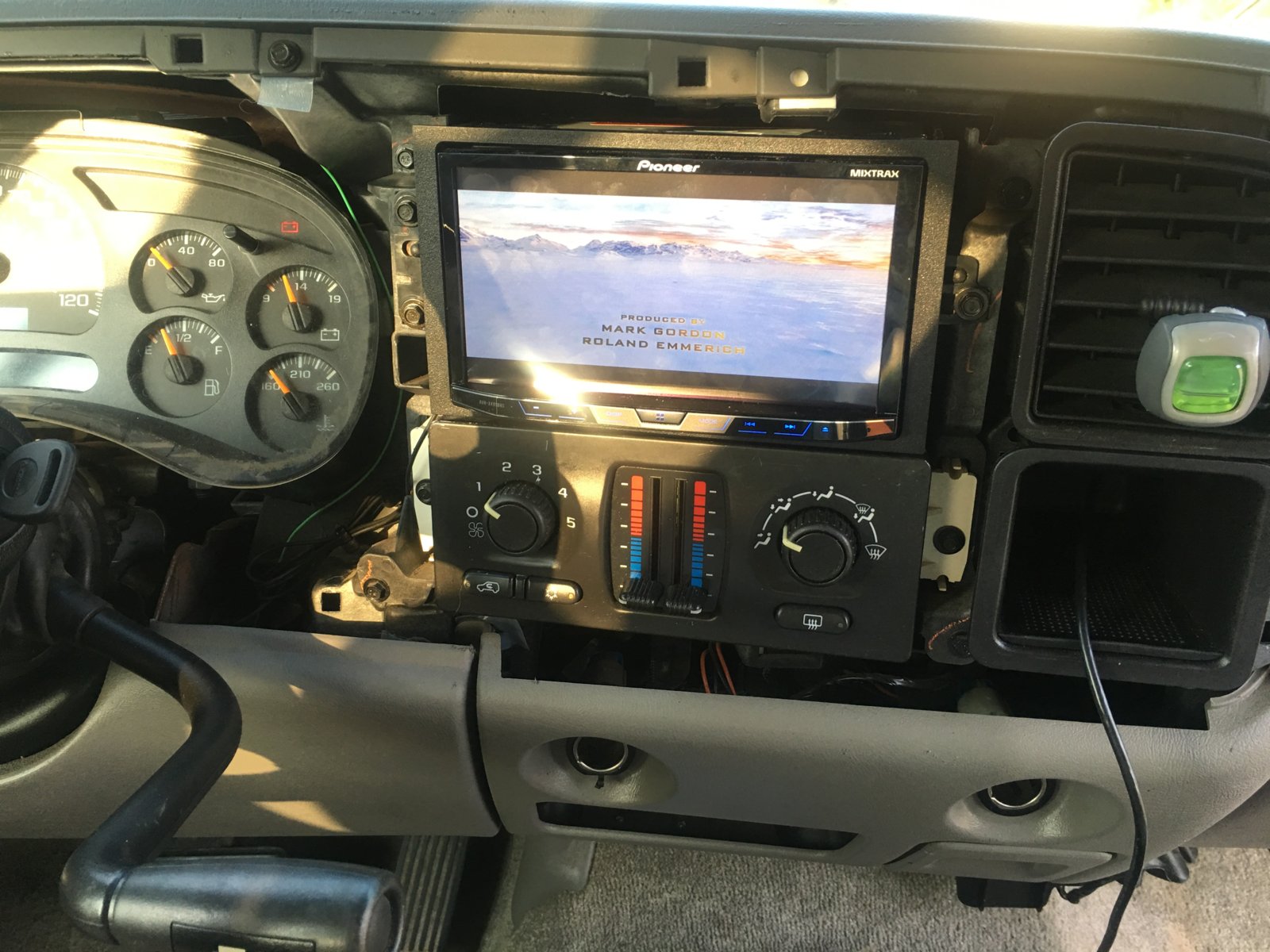

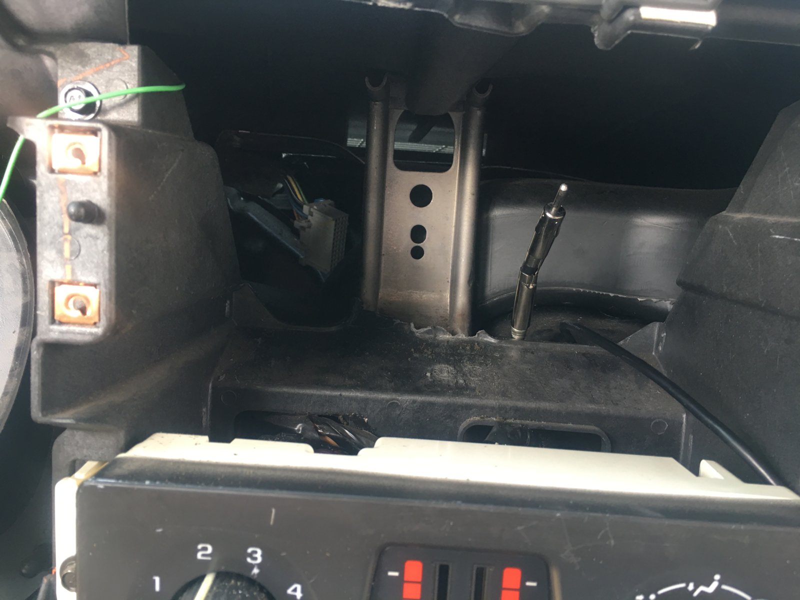

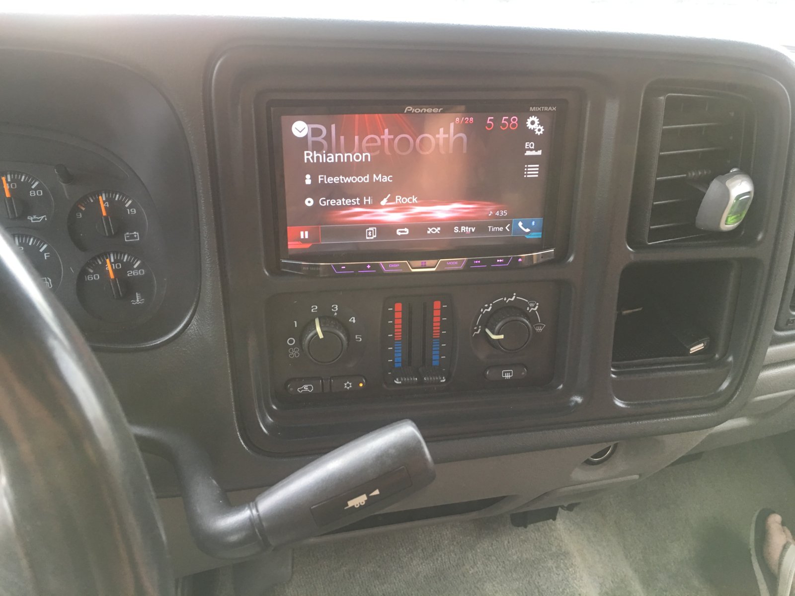

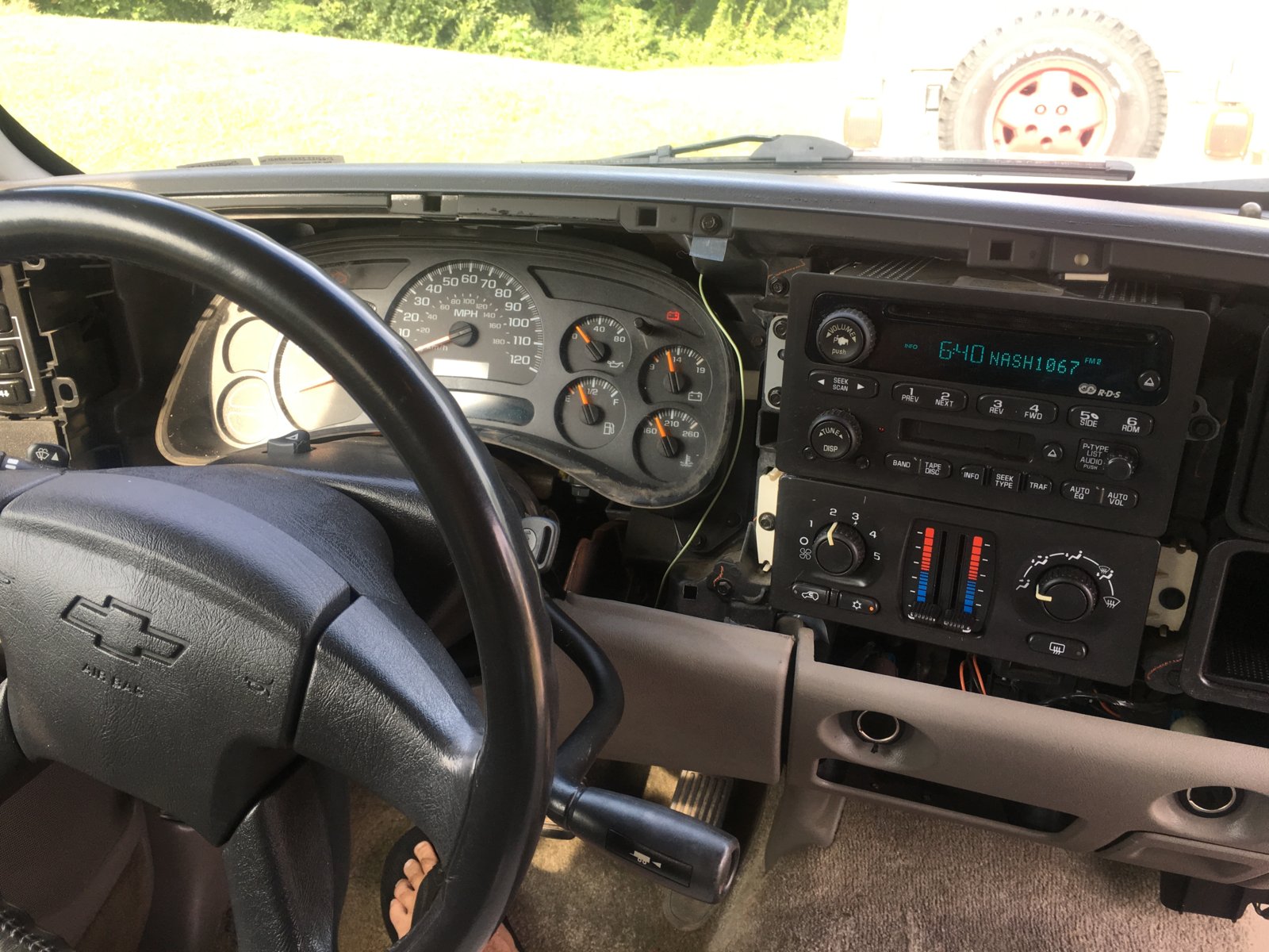

Finally, here are the install pics. For anyone who wants the Pioneer AV-X491BHS, it is too big for the factory depth. I had to trim the plastic and metal bracket behind the headunit. Nothing up front needed touched. Also, Pioneer requires a on/off/on pulse for the parking brake. I added a toggle hidden in the cubby to the right of the stereo. I also ran my USB extension through this same cubby. I'm thinking about removing the cubby and making a block off plate out of black ABS. Then I'll mount the toggle and a USB port in the panel.
I'll post a completed photo in a bit. It was dark when I finished.
