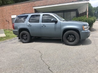

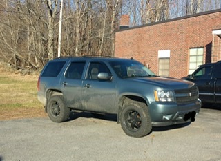

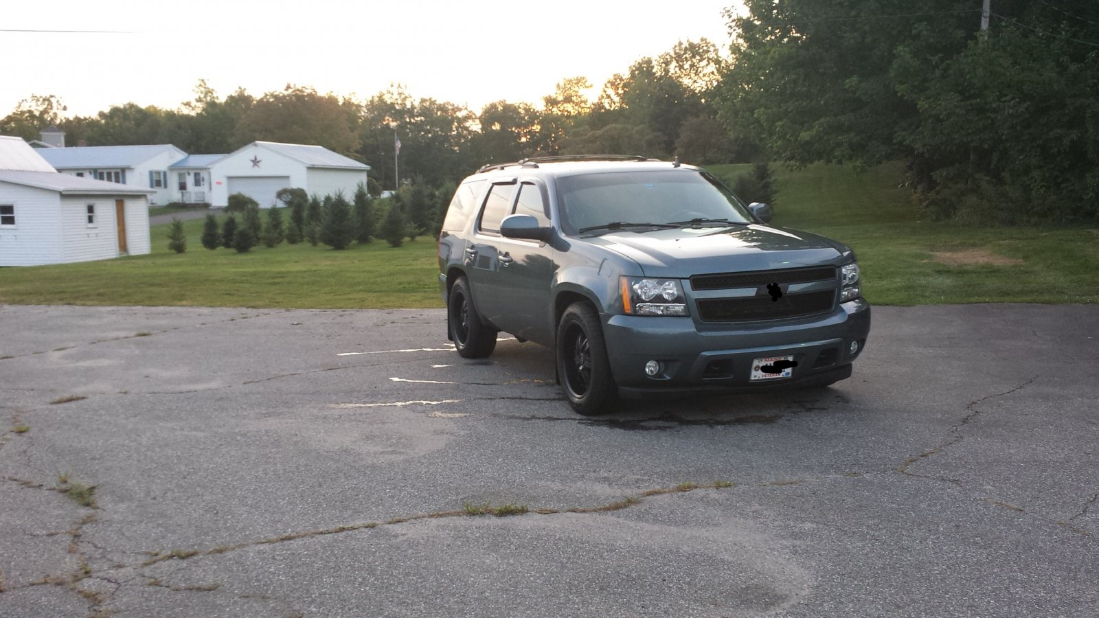

lowered 275/55/20
lifted 275/60/20 aka 33s
stock worn 275/60/20 32ish”

yeah i love this color. Its very close to our state police color hahaha
It's awesome - is this the color they call Granite Blue?....Are you currently at stock height?
